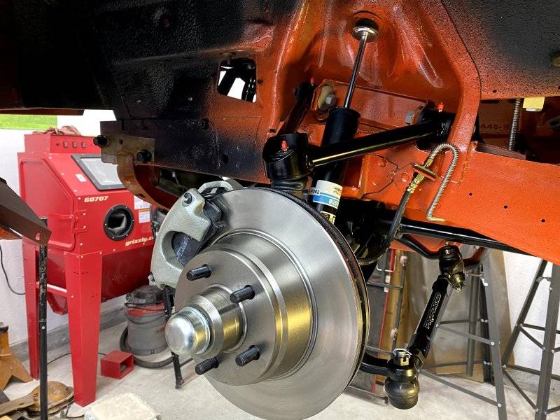

While my car is apart, I'm considering a switch to the larger 11/16" tie rod ends that the C body cars used along with solid adjusting sleeves. PST has them and they appear to be decent quality. I have one outer tie rod end that feels loose and two of the grease boots are torn so I am looking at replacing something anyway.
I do have big torsion bars, a 1.25" front sway bar, boxed LCAs, Bilstein shocks and 275-40-18" tires. The stock 9/16" stuff is probably just fine for a cruiser but I thought if I needed to replace something that I might as well make an improvement.
I haven't got them but I've been considering them for awhile and will change them down the track.
The standard size seems a bit flimsy and the hardware on the PST replacements I got were a bit cheap. I ended up using some of the original hardware after I stripped a few bolts when tightening them.
I don't like the way they only seem to clamp on the final pinch - for such a critical part I've always felt they should have a more solid connection, even though they seem to work fine in practice.
I run the 11/16" stuff on all 3 of my cars. I have both PST and QA1 solid adjusting sleeves. You can't go wrong with either company.

I've got PST's 11/16" sleeves. I don't think you'll be disappointed. My car is apart so I can't tell you how they drive yet, but the stock sleeves are so flimsy compared to the PST sleeves, I doubt you'd ever want to go back to them unless you're trying to save every ounce of weight.
From some of the stuff that I have read online, the open section between the clamps can spread open causing toe out.

My stock sleeves were fine with at least 106,000 miles on them, but I never tried jumping the car. I can see how they wouldn't be adequate for the cornering forces generated by big fat modern tires.
I installed the C body tie rod adjusters on the Coronet. Also boxed the LCA's, and steering box mount on the K. Swapped in larger T-bars, tubular UCAs from PST, SFC from USCT. Stage III p/s box rebuild by FF. I did everything during the resto so I can't say which one of the upgrades works better than the other, but the car handles as well as a late model sedan.
