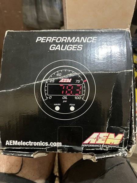

About to install a 340 to replace the 318 in our '72 Satellite Sebring Plus. May start it up using the Carter two-barrel and install the thermo-quad later. I have an AEM air/fuel ration gauge collecting dust on the shelf I would like to use (model 30-4110. I would like to know somehow who has experience with this type of monitoring because I don't want to run too lean on cruise a damage the internal engine components. Thank you. (posted on FABO also).

Since it’s older I’m guessing it’s narrowband? I ran a similar gauge in my Miata when I went forced induction and it was helpful.
