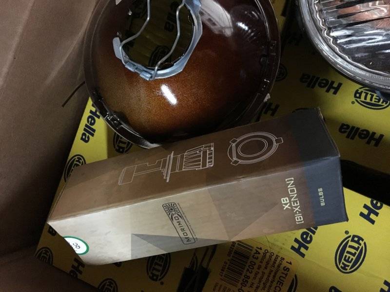

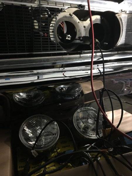

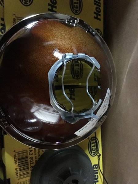

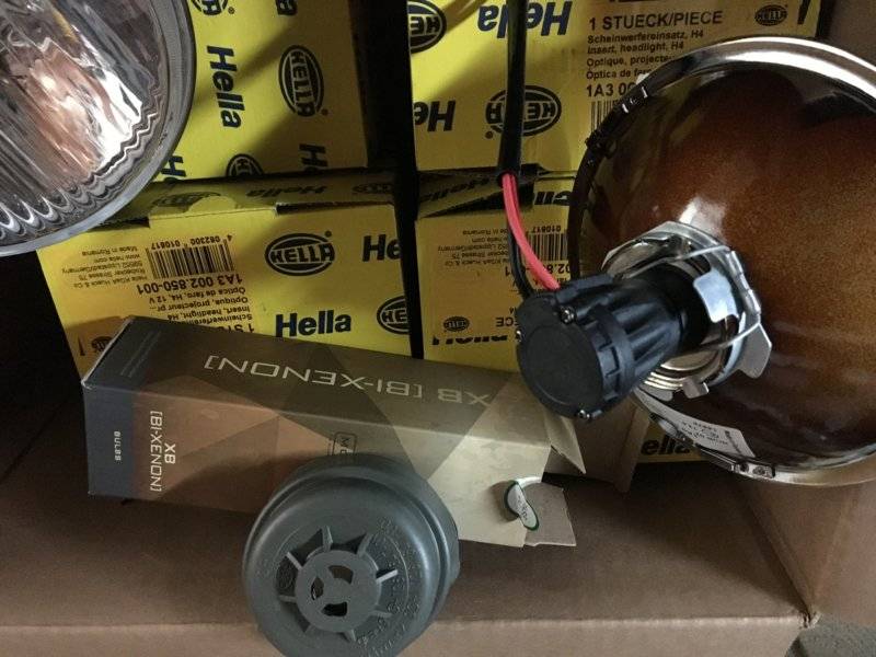

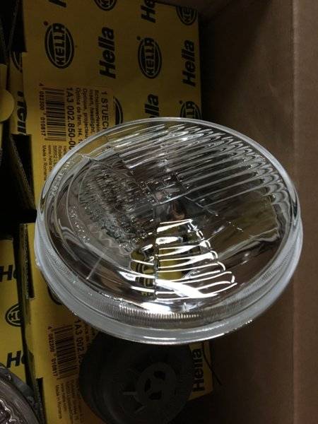

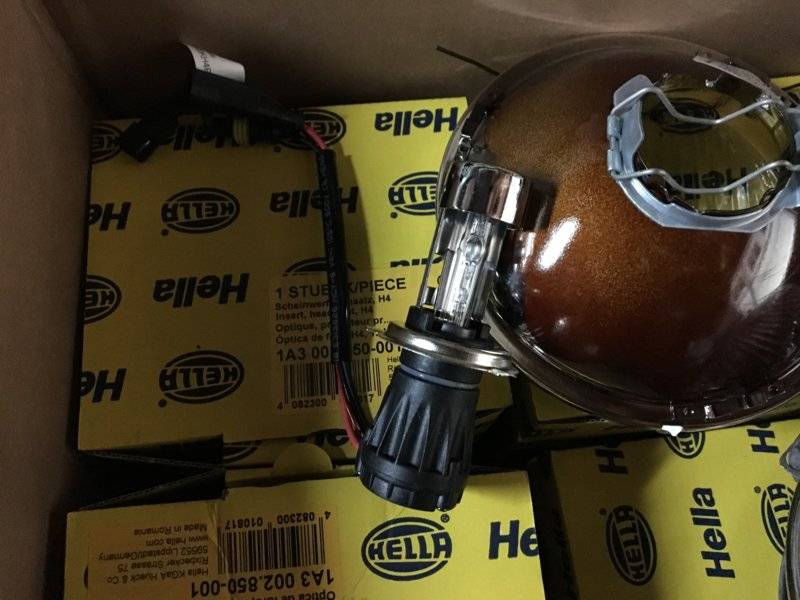

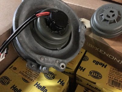

just took some fresh pics for you. see if they help. see the empty glass, glass with HID bulbs installed. the Hellas came with a weather shield that i had to trim and fit over; should keep things dry.

Thank you, that looks great. I was stumped by the weird headlight door issue and figured I'd revisit the relay issue later. The current draw of LED is what tempted me but the added complexity of ballasts, etc just confuses me. Sometimes, the "not knowing" makes a project seem to be more hassle than it is worth. I'm reasonably skilled with most things but I really wish that I had a better understanding of electrical systems.

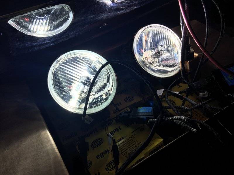

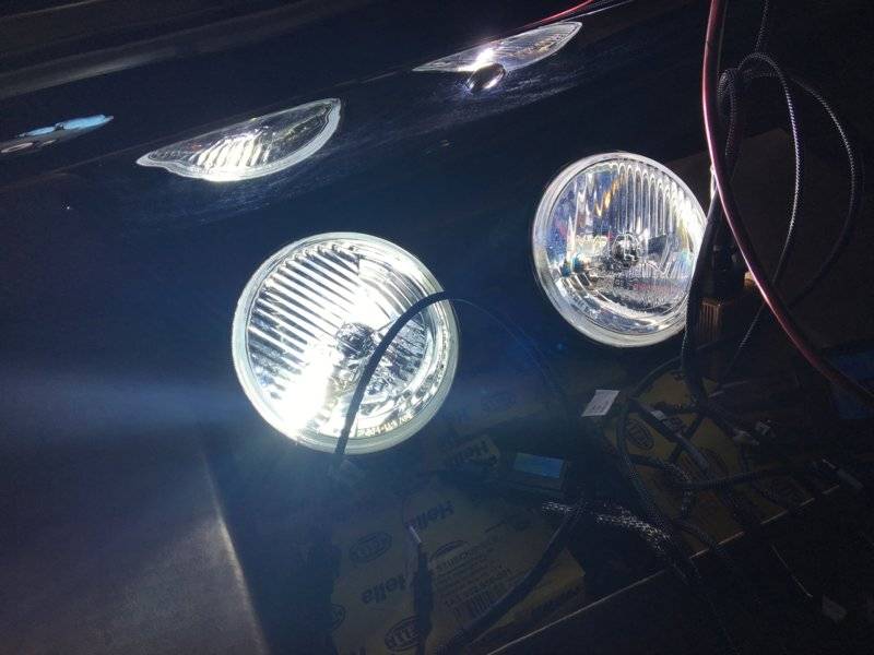

just did a bench test. 6000k HID bulbs with 35 watt ballasts. the setup is super white. all lights on when on low beam then all lights on when on high beam. i tried to get pics dead on in front of lights but camera got whited out.
now gotta mount things up.
