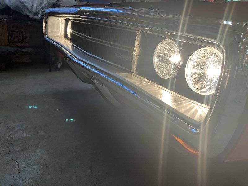

New bulbs are in.

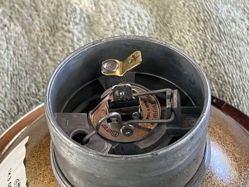

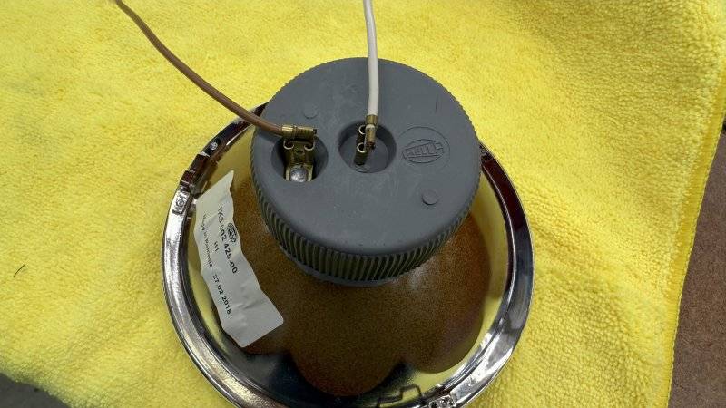

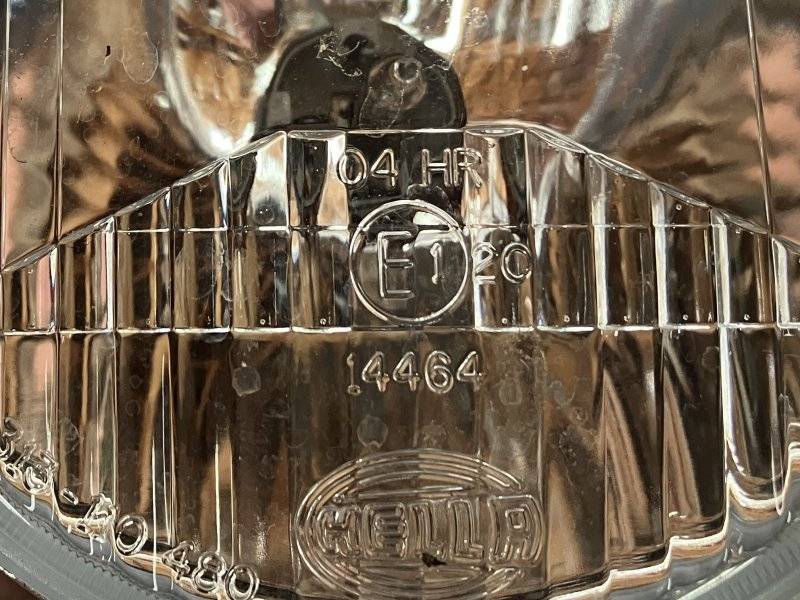

First, the high beam.
I thought I’d see an H1 on the face. I do see an HR.

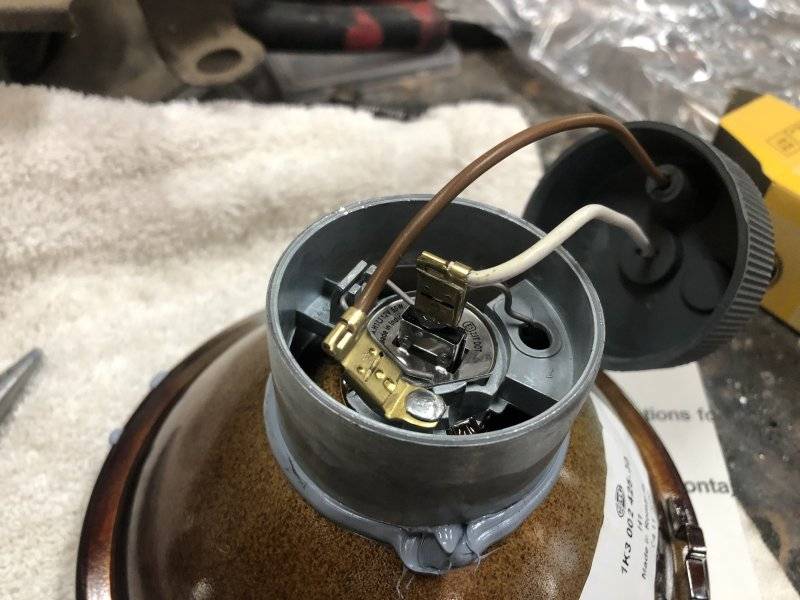

Like a member mentioned, the ground wire goes to the housing. It was several years ago that I put these in so I did not remember.
Single spade does work. I’m surprised to see 55 watt. I thought these were 60.
The irregular shape ensures it is installed only one way.

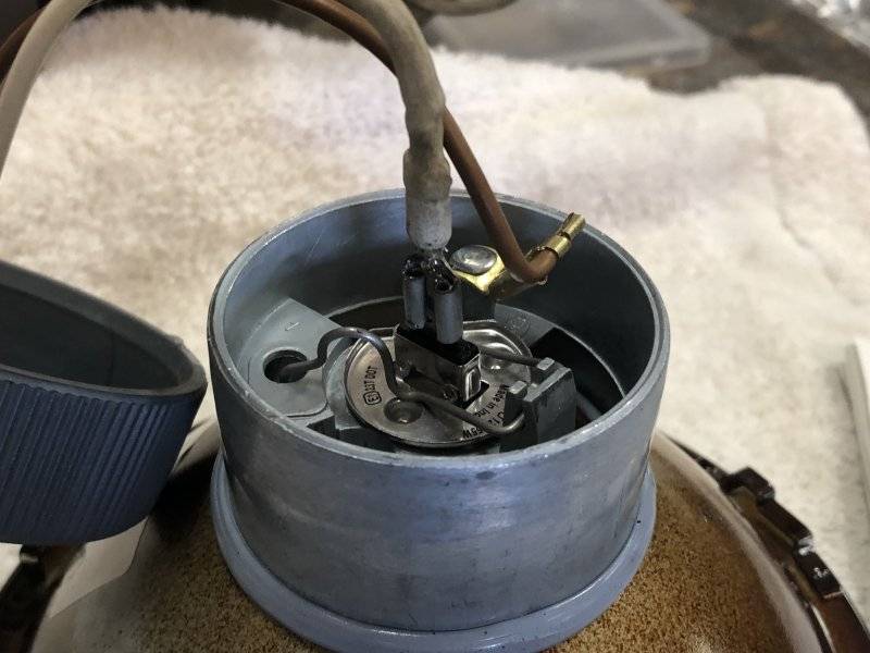

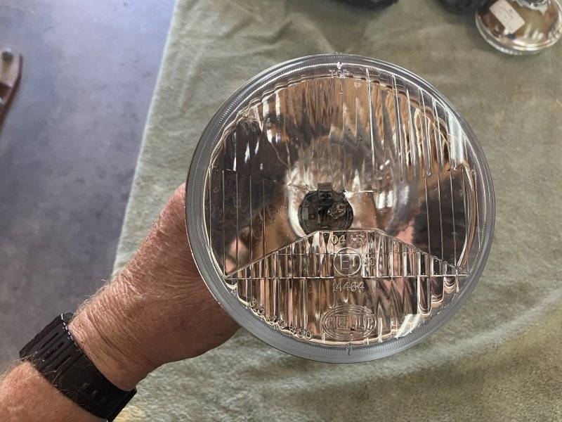

The H4s high/low are next.

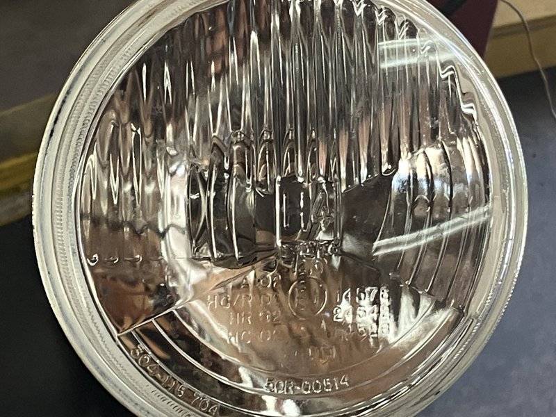

Looking at how the glass is, you can see the bottom 40% to half has subtle flutes. Above that the vertical flutes are more evident. This results in a light pattern that has a bit of a cutoff as seen in previous pictures.
Typical 3 prong arrangement.

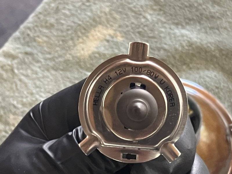

Get your reading glasses for this one.

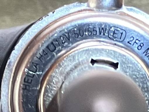

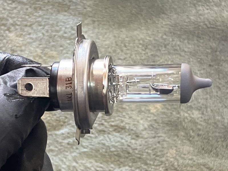

50 / 55 watt?
I thought these were 55/60.
