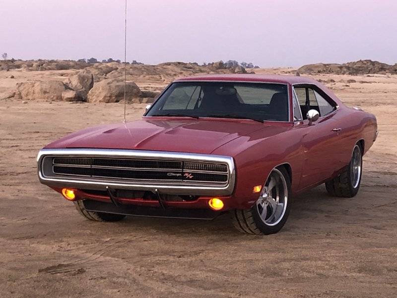

We don't always drive in just the daylight. Who wants brighter headlights?
A couple years back, I added the headlight relay kit offered by a fellow FABO/FBBO member. This kit is strongly recommended if you have standard sealed beam headlights but considering the drastic reduction in current needed to power LED lights, I don't see why the relays would be necessary.
I had sealed beams for years but changed over to Hella H1 and H4 headlights.

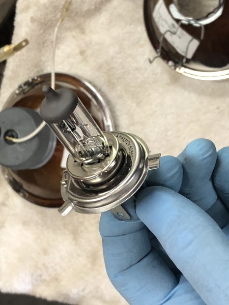

The H1 are a single filament for use in either high beam only or low beam only. The H4s are dual filament for high and low.
These have replaceable bulbs.

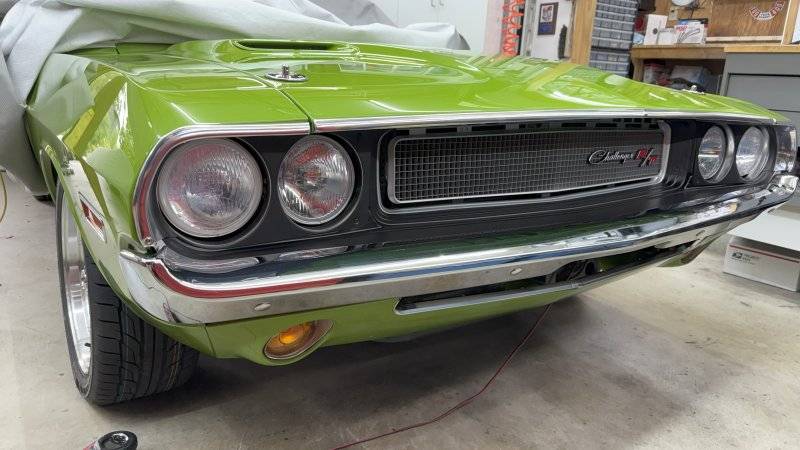

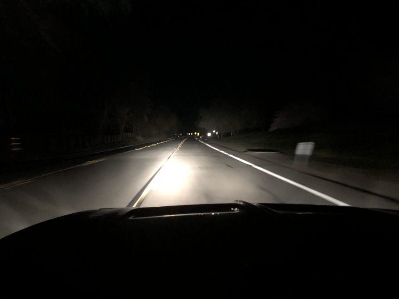

In general, I've been happy with them but I need to learn how to properly aim them.
It seems that the low beam on the left aims low.
Same with the high beam on the left.
The right side seems to be aimed right. These are the lowest wattage bulbs that came with the headlights, 55 watt low beam, 60 watt high.
I'd be interested in suggestions on how to properly aim headlights without using any fancy equipment.
Thank you.
Also...Is it possible that the recessed headlights in the car affect how wide the light pattern travels to the sides of the car? It seems that it could as compared to a Plymouth Satellite or a Dodge Coronet.

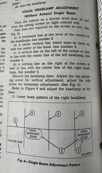

pull up to an overhead garage door or similar large flat vertical surface about 15 ft. away.
turn on headlights
adjust away.

below centerline of the headlights @ 25' away, at least in this part of the world.
Side to side is pretty self-evident as well.

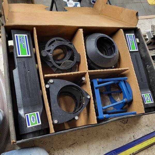

I bought one of these Hoppy headlight aimers on Ebay several years ago for not alot of money, I think it is from the 70's. It is pretty cheesy, but works surprisingly well.
The left lamp is supposed to be adjusted a little lower and toward the center to keep it out of oncoming driver's eyes. Illuminating the centerline is about where I want to be. I can see where newer designs with higher intensity would be a plus as long as you adjust them properly and keep from blinding the oncoming drivers.
Best to place your body weight of ballast in driver's seat and have 1/2 tank of fuel to really dial it in
I used that exact tool when I worked a at Chry-Ply dealer 1969 to, 1979. I had to check alignment on all new cars when I serviced them.

1. Park the car facing a garage door so the front is square to the door, about 15~20 ft away. Make sure you have level surface from the garage door to the car, not at a slant, etc. if not use a buddies driveway that is flat.
2. With the headlights / vehicle off - Measure from the floor to center of the head light. This is your height reference point.
3. Using your tape; measure at the garage door up to your height reference point - you're going to put a length of tape on the garage door horizontally longer then the width of the car.
4. Add a smaller 6" piece of vertical tape at the center of your horizontal reference line on the garage door. Matching up with the center of the hood. Use a laser light or flash light if you're unsure where this lands on the garage door.
5. Measure from the center of your cars hood to each head light & transfer those marks to the garage door using the tape - so you end up with a grid / targets with the marking tape.
6. (optional) I'd also mark in chalk where the tires are , in case you need to come back in for adjustments - you can get in the same spot being consistent.
7. Start by aligning 1 head lamp at time & covering the remainder with card board or towel. NOTE : i think those H4 bulbs are super hot; best to block the light with something a little further back. i.e.: garbage can with large card board about a foot from the head light not to cause damage.
8. Turn on head lights (start car if you need the headlamp doors to open l like i need) With 3 head lights being blocked off, you will witness one beam on the garage door.
9. Using a long Philips screw driver, you will adjust the windange and elevation. Make note of where each adjustment screw is on each lamp in advance so you can quickly access them. if you do this in the dark like i do, you may need the flash light to locate these on the side of the lamps.
10. Start by aiming the elevation of the beam slightly below the horizontal tape mark it should be alignment with / then the windage so it intersects your target on the door. This should be set & you can move to the next one.
11. move the cardboard (light blocks) accordingly so you have the next light hitting the door.
12. repeat the adjustment in step 10. until all lights are on your marks.
13. if dark / dusk, go test drive down the block & make any necessary adjustments by parking the car right back on your chalk marks
(tip) if you live in the country where deer are an issue like me. i aim my passenger low beam slightly toward the ditch.
(tip 2) you can aim the high beams right on the target instead of slightly below, this would be optimal light projection.
Hoppy headlight aimer FTW!
I used those many years ago when I worked at the dealership in the 70's and 80's and they work great. Even better if you follow the instructions.
I came across a mint, basically NOS setup on FB Marketplace for $50 a while back. Still had all of the original paperwork and the VHS instructional tape in the box.

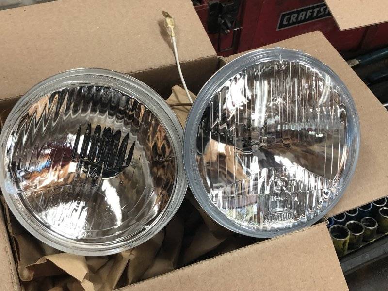

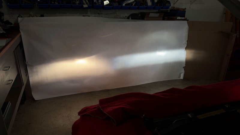

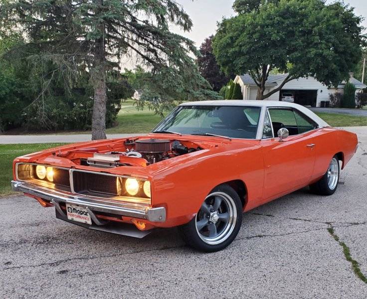

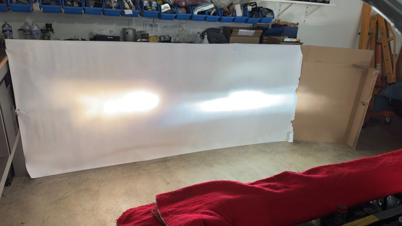

Have installed many sets of those E-code Hellas. Only way to adjust is the method mentioned already, pull it up to a flat wall, 15-20 feet away on a flat surface. I will bring fender covers or something to hang over and block all but one lamp, adjust one at a time. The low beams have a distinctive horizontal cut-off and another cut-off angled off higher to the right, starting mid-beam to reach further down to road to the right, avoiding on-coming traffic. Will normally swap out the lower wattage bulbs the kits come with for 100/80 watt H4, and 100 watt H1 versions. Relays are a must with these lights. Have recently changed over a couple of cars to Holley Retrobrights, too used to the whiter color temp now, thanks to more nighttime driving in modern daily drivers, in some ways prefer the Hella light pattern/coverage. Would still run relays on the LEDs, stock headlight wiring/components are just so undersized/unreliable, the Retrobrights are still drawing 4-5 amps each.
Hellas left, Holley Retrobright right, low beam.
High beams
