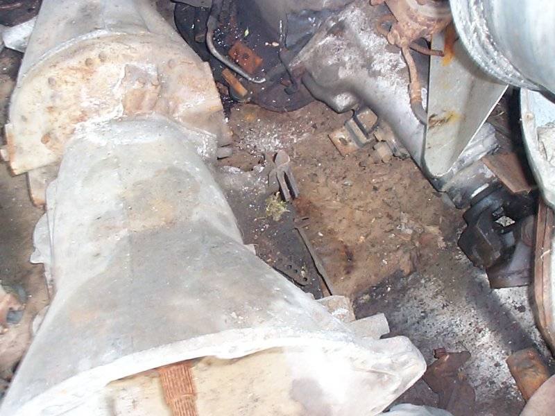

Some MotorHome , but mostly D500 to 700 series had a 4 speed A345 with a first low gear compounder added to the back of transmission. 1st was 3.45 , 2nd was 2.45 (stock 727) 3rd 1.45 and 4th direct. You can see the basic 727 with extra components. Very heavy for a car or light truck. They had a deep pan , but it was to make room for thicker valve body.
Looks almost like a gear vendor.
