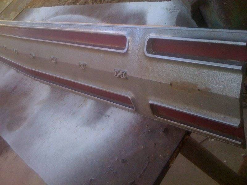

New digs are awesome. Best thing I've ever done. I'll figure out the door panel. I think its fixable to use in a race car.
True and true.
I had a similar problem, and bringing the pieces together made the damage virtually disappear.
I used packing tape on the front to hold the pieces together, stronger hold and flatter than other types like painter's or duct tape.
Flatten the piece out with the tape on, and make sure it's flat and together.
I then used superglue on the seem from the back, just a little on the seem and spread it out.
This kept the seem together, prevented glue from leaking through, and it from sticking to the work surface.
I did very short sections at a time, small length of tape, glue, wait for it to dry, continue.
This ensured each section was together prior to glueing, and that the tape wasn't on the front for very long.
Test the tape first, obviously.
Last step, I used gorilla tape on the back as extra insurance. It has alot of glue on it and I worked it into the back.
Thanks! And this is exactly what I was thinking. Since the panels "broke" instead of ripping, they didn't stretch and the break is super clean. When I lay the pieces down, the seam virtually disappears. I think it will be a tedious process but I'll give it a shot. lol.
If you can get the puzzle of pieces back in place, I would apply some fiberglass resin then some fiberglass mat and seal it with additional resin. Then a little sanding to make it smooth.
This would be my thinking and attack plan to repair it. Good Luck
