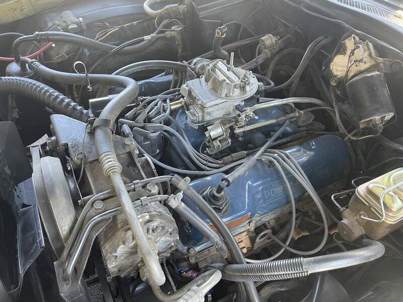

So I stumbled on another I’m just going to go look and ended up taking it home. The car is solid as can buy there are a few issues.
first off there’s a lot of things missing or cobbled together. For one there’s a lug but capping off a carb port (no joke) and there was no air cleaner but I towed it home so it hasn’t seen much run time without the air cleaner. I will say this things is smooooooth but I’d like to get it road worthy so what do you see here that needs attention or is missing ?
This is how the car was running and this is what I found after removing the air cleaner
I’ll post some pics of the whole car in a bit

Depending on what year that vehicle is it is either a 351 Cleveland ( up to incl 74) or a 351 Modified (used from 75 and up) it could also be a 400 Modified, it would designate on the drivers valve cover decal. If legible.

That’s not a 351w
Not even close. How bout the size and shape of the heads and valve covers, Ray Charles could see that.
Size of ports on the intake and exhaust manifolds. Look at the oil cap mounting area.

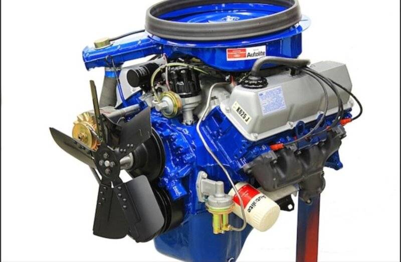

here’s a pic of a Cleveland..

Dan Juhasz is dead on, it could be any of the three he mentioned, depending on year. One thing it isn't.....a 351 windsor.
That’s odd because I had a few ford people look at it and they all said it was a 351 Windsor
hmm what should I look for to check ?
Valve cover size and shape, number of valve cover holddown bolts. Windsor uses sixbolts, and the ends of the cover tapers, wider at the header flange than at the intake side. Cleveland uses eight bolts (429/460 uses seven)
