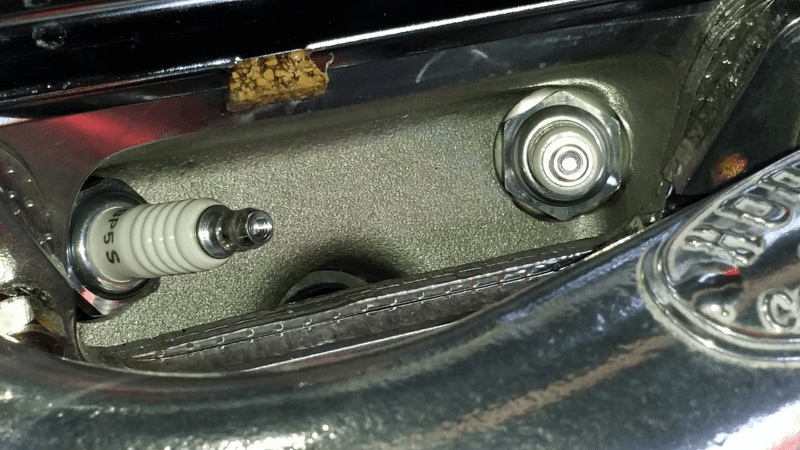

I have custom made gaskets from a little shop in the Bay of Plenty here in NZ.
https://www.gasketsbop.com/
Cheap, and fast service. Takes the guess work out of potential exhaust leaks.
All I had to do was provide a sample with my requirements...got gaskets by return courier 4 days later.
Sparkplugs are only in loose to prevent foreign objects entering the cylinders. :D
I also used studs with serrated lock washers...they are not coming loose by accident.
