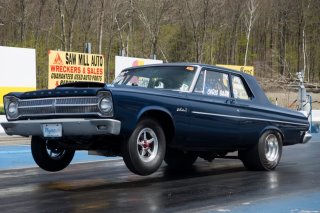

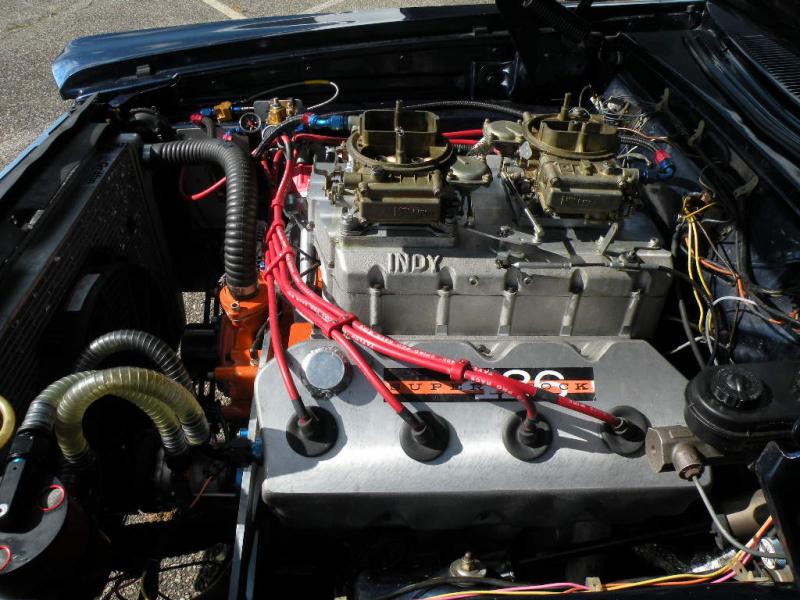

The holley's that were used were Ray Barton tuned and modified correct 770 super stock holley's vacuum secondaries. These are the original replacement carbs. Engine was on dyno with these holleys and engine made 931 hp @6700 rpm's.
Jetted them up and made 10 passes with them. Engine builder felt that we could make more power with them. So we didnt try the edelbrocks on the dyno at all.
Switching to the edelbrocks netted me a solid .2 as of now in bad air. I cant wait to see what this car does at Island or Atco in the fall.I'm very pleased with the results and I can guarantee a 1.26 60 foot in better air or close to it. Not too bad for a 13.5 motor.

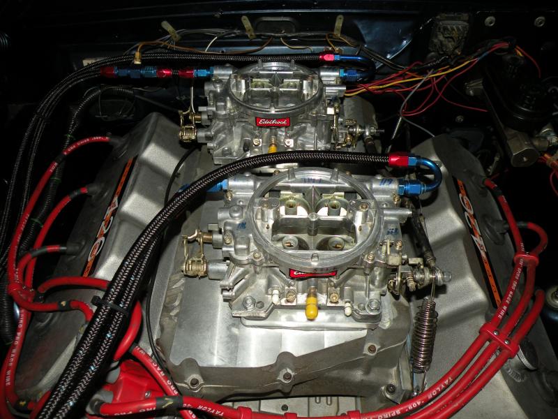

A/F is 12.40 left and 12.75 right now. Still a little rich but getting closer. That means I still have more in it.
