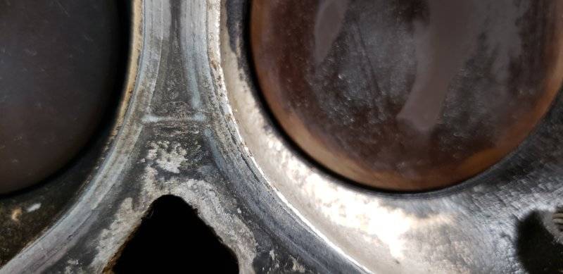

I remember this being a big selling point about being reusable. I Had to pull a head to figure out why a leakdown test on #5 with the piston at TDC pushed coolant out of the radiator. Looks like it was coming in right where the little embossment is before passing between the cylinders. I'm going to deck both heads, pressure check them, and reinstall.

Not sure which heads you have, but most heads do not come from the factory with a smooth enough surface for Cometics. So some leak when new but seal after some heat cycling and retorquing. Some guys use spray sealant (copper spray) on them. Some seal just fine as is and dry.
The block and heads have to be very smooth: 50Ra or better. Edelbrocks are on the line out of the box (50-60Ra), and should be touched up by a modern cutter to get the right finish if you want to ensure they're "right". Also to ensure they're actually flat... I've not seen any factory machined block, or a block milled by anything but a modern cutter (not the usual oldschool milling equipment but a machining center) that leaves the correct surface. Those can leave anywhere from 60-100Ra. The higher the Roughness average number, the rougher the finish.
I'd have your heads cut flat on modern equipment, and if the block is not that smooth, degrease them and spray a light coat of coppercoat on them. I'd also retorque after the first heat cycle.

It was Cometics that were leaking. I bought the heads new, ran them with standard FelPros, pulled the heads for porting, and reinstalled with new Cometics. Now, 5 years and 3000 hard miles later, I have tracked my coolant loss issue to that bad spot on the head. The heads still have the edelbrock deck finish on them. Maybe that was not good enough. The engine got really hot once in 2016, 250°+ while stuck in traffic with nowhere to pull over. That may have caused the initial failure. I've been chasing the slow loss since about that time. It will never run out, just lose about a gallon then maintain. I'm debating getting new Cometics, reusing these with some spray, or looking for a new option. I'm 4.36 bore, chambers matched to the 4.410 gasket, and cannot be less than .045 since I have closed chambers and am .007 positive deck.

I only used them because after losing a crank and going stroker as a replacement, this is just what the only combo that gave me the compression I wanted came out to be. I was zero decked prior and the new setup came out positive .007. New .045's and +.007 gives me a nice .038 quench. I'm going to go ahead and replace them because they have already leaked. I can blame it on the overheating, and I'll just start over with a fresh cut on the heads and fresh set.
I reused mine 3 times before replacing them. 15-1 compression.However I never had a leak. How does the gasket appear at the leak point?
I'd be hesitant to reuse a gasket that was leaking.

The gaskets look fine, save a few spots where the black coating stuck to the head or block. I'll still replace them because they DID leak, whether or not it was their fault.
