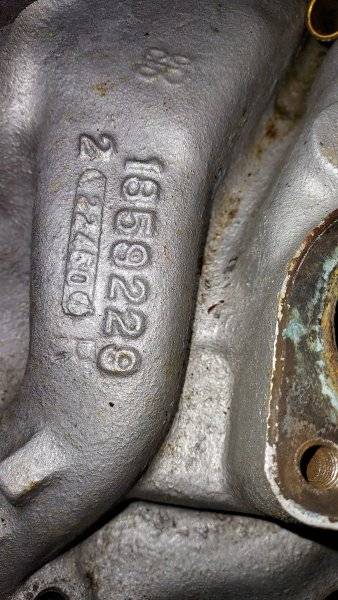

So here are some pictures of my setup. It's far from ideal but it's all I could come up with at the time. Pretty willing to bet my flow is severely impeded!
[1] Carb pad is for an AFB, narrow bolt pattern. AFB mounting feet are wide; some AFBs came drilled with the narrow pattern; some were drilled with the wide pattern. Either way, the mounting feet can be drilled to accommodate either/both. Same for AVS & Edel carbs. I would get rid of the POS Holley. You know the boat anchor you need.....
[2] That spacer is killing the performance. What you need is a 4 hole spacer. You might be able to find a Holley spacer that has the dual mounting pattern mounting pads [ the outer mount holes on AFBs are the same bolt pattern as the 4150 Holley ], so outer holes would be drilled but enough room inboard to drill the narrow pattern. Or you might be able to find an AFB spacer, narrow pattern. Offenhauser used to make a huge range of spacers, not sure what is available.
[3] The smartest thing you could do would be to get the Edel 500 AFB or AVS. You can drill the mounting feet & it will bolt on, no spacer reqd. Get the credit card out!

I already had an edelbrock carb on this exact engine in the beginning right when I put the manifold on, and it didn't line up with anything. The bolt holes lined up, but the butterflies did not. It was a square bore carb and neither the primary nor secondary butterflies were able to open. It was weird. That's why I thought maybe this intake was meant to fit a different type of carb.
From the pictures it kinda looks like that might be the ticket to at least getting the carb on to the manifold correctly. Whether it would fix any of the issues would be the real question.

Really odd that the AFB doesn't line up. The intake came off a 61 Dodge?
AFBs came out in 1957.
