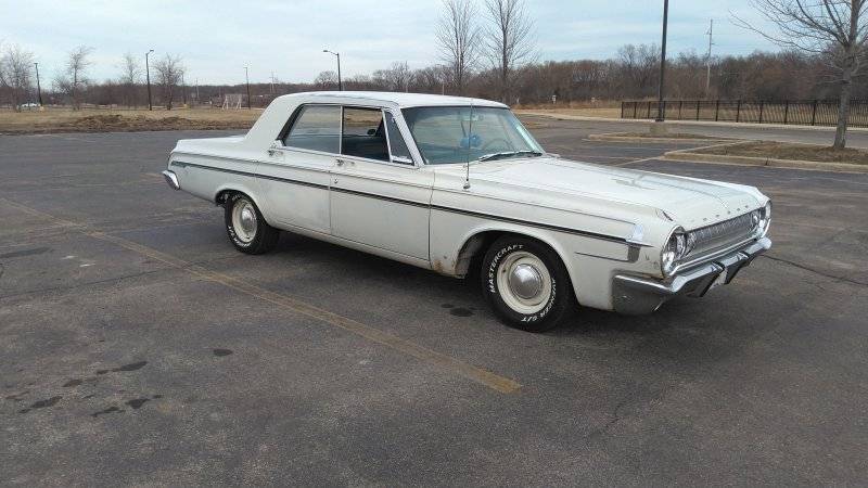

Another '64 Polara 4-door hardtop! Here's mine. I replaced my 313 ( Canadian ) with a 413, and now a 440. I can't help you with your carb problem other than to say that something is drastically wrong to slow down so much, with big change in mileage.
That is sweet! Someday mine will be the same...some day...
