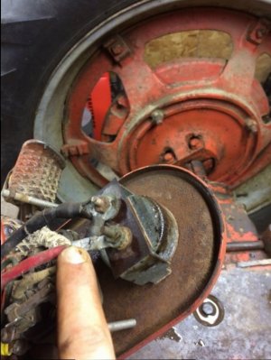

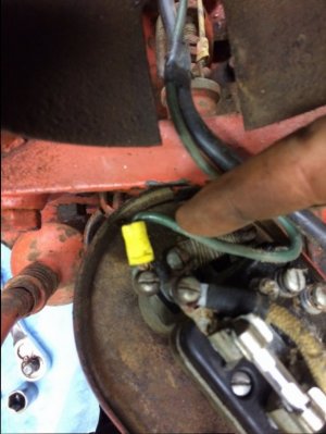

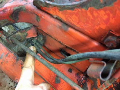

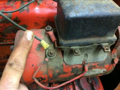

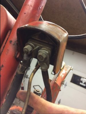

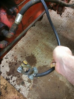

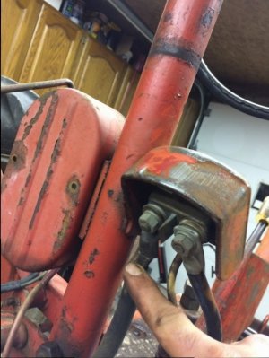

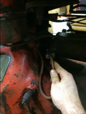

So I repainted my Farmall H and now it won't even try to start. Pretty it's all out back together correct but I replaced the wire on the generator that goes to two points on the generator and it seemed to fry. This was connected for maybe 2 seconds and disconnected when I saw smoke. So what could I have screwed up? Also, when I took it apart it's still a 6V system and it was negative ground. How do I make sure that's not my problem?
And don't mind my finger in the last one as that is not the wire in question. The red wire is with the the break

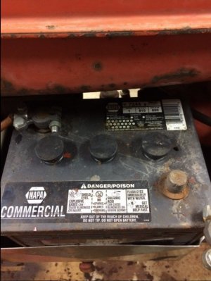

Originally they are but 90% sure I took it apart as neg ground which didn't make sense to me but I know there is ways to switch them. How do I check? Can I just try to switch the battery or will that blow stuff sky high?
I'm not sure how anyone would go about changing it to negative ground.
In your picture of the battery, is it a "before" picture? Can you remember the cable that is still attached if it is?

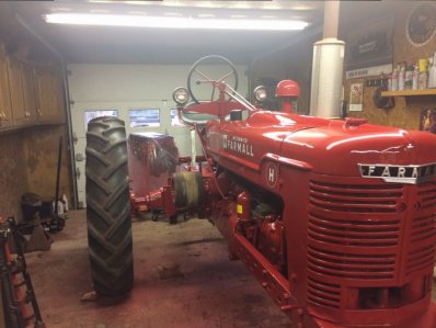

Nice tractor.

It is a before pic and the cable still on is the ground. So unless I really did something after a night of working and the whiskey, that's why I thought it was neg ground
Thanks for liking the paint job by the way. Three months of prep on that

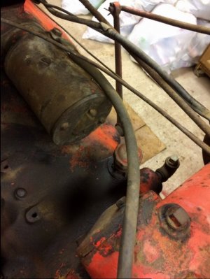

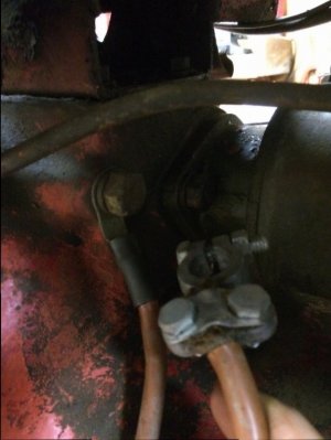

Do you have a cross pick view?

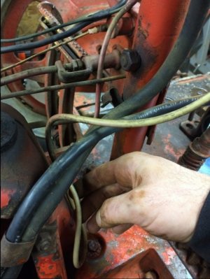

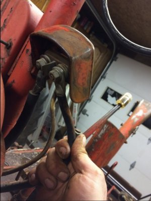

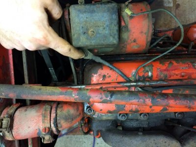

She's a '46 and I don't know how long it was like that before IFFF it was and I didn't screw up. I can try switching, just wanted to ask the professionals on here before I blew more stuff up. These were all the electical pics I took during tear down to put it back rogether.

I'm seeing wiring on there that I don't recognize.
Generators can be polarized negitive or positive. Its been over 40 years and I have forgotten how.
True, anytime you replaced the generator or regulator you had to polarize the charging system with the engine running by (if I remember right) using a jumper wire to ground the field wire momentarily. Then check the ammeter to see if the needle pointed to the charge side.
