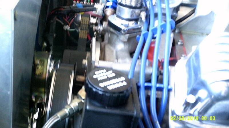

this looking down in from the pass. side belt routing under the wp etc.
75 amp alt. helps with all the extra electronics
from drivers side PS pump belt, had to use an idler pulley
to clear the wp with the serpentine belt
68 RR #37 Power Steering Pump for Unisteer rack & pinion serpintine belt ds.JPG

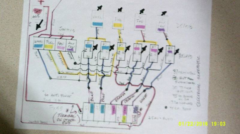

sorry my photos suck, here the schematic to how I have mine ran
wasn't really for public consumption :poke: I'd have done a better job

& I went to a local Napa/Debco to get
the idler pulley to keep the PS belt away from the bottom of the WP
was from March Industries IIIRC too
(I made the mount for the idler, to use a 1/4" piece of 7075 alum. plate
to the top of the WP bolt support for the Org. PS bracket)

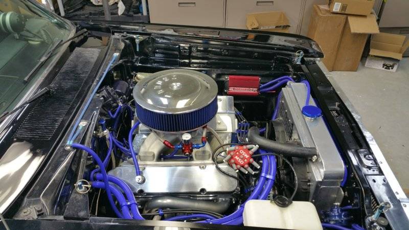

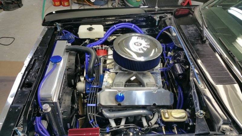

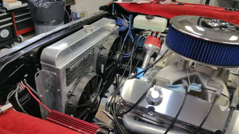

It is the CVR 55gph pump going through a Smith Bro's radiator. The radiator is a 26" (two 1-1/2" rows) with a homemade shroud with dual bypass doors for when I am at speed. I have dual 12" Spal fans and a Derale progressive controller for the fans (with manual override available for both the fans and the pump). Best guess based on my build is that the engine puts out somewhere in the low to mid 700hp range (no dyno or track results yet, only dyno software). Cooling it since I put this system in has been a non issue which was not historically the case. I used to fear having to sit in any kind of line getting into a show or just stuck in traffic. I may put a belt driven WP back on it to see if that helps on the longer cruises but I really like the ability to leave the pump and fans run for a bit when I park it to help with the heat soak issues I sometimes have because I use a mechanical fuel pump.
View attachment 925048 View attachment 925049 View attachment 925065
