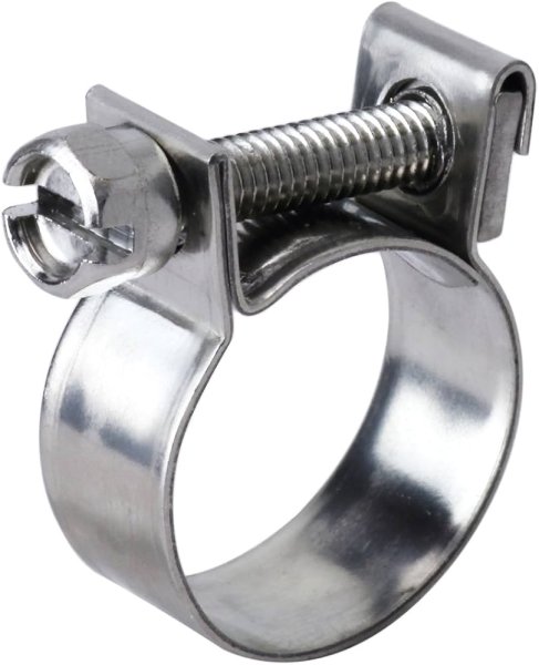

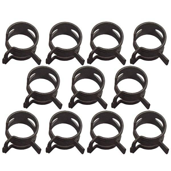

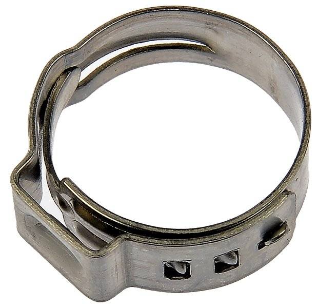

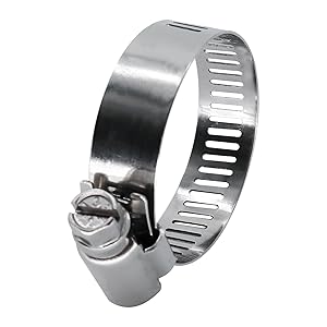

A few general comments on the pictures posted earlier.
1) looks like old hoses. Replace them.
2) do the old hoses have markings to indicate they are rated for gasoline? You can check after you replace and throw them in the trash can.
3) Take a look at Gates Barricade hose. It's compatible with all types of fuel.
4) worm drive clamps...not stock items...used when the stock hoses were replaced with unknown hose grade in the past. I used to use the worm drive style of clamp on all types of hose, but not any longer.
I no longer use these on fuel hose.
I now use the following types on fuel hoses. Accessibility sometimes dictates which one to use.
You will need a special clamping/crimping tool/pliers for the last one. Buy extra of this last style in case you get the crimp wrong.

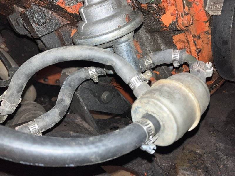

My favorite hose cluster. Not!
Yeah that's going to need to be addresses as well. Any idea what he was thinking connecting the return line through the feed filter? Just from the flow standpoint alone that's counterintuitive. I doubt the return fuel even ends up in that filter at all.

My plan was to fix the sending unit and route the return back there to the small nipple where it belongs. The only thing I’m scratching my head about is why he routes the return line from the pump back into the filter shared with the feed line. But I did some research and it’s common. Lots of people saying helps equalize pressure. If it works I guess it works but I would have fed the return line direct to the tank.

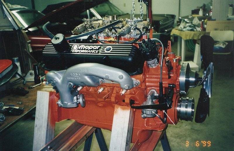

That setup with the filter is the same as the vapor separator and is much cheaper than the mopar separator. Biggest problem is the Mopar vapor separator has a smaller orifice in that 1/4" nipple that returns excess fuel back to the tank. It was designed to stop vapor lock after shut down. The fuel left over in the pump would boil and cause vapor lock. The return line eased that problem. The issue with those aftermarket filters is there is no regulating orifice in most of them and it allows too much fuel to go back to the tank starving your engine. You didn't mention that your engine was starving so it is possible that your filter has some reduction flow. Mopar fixed a lot of problems before we even knew they could be a problem. However, it seems like we try to cheap charlie the system and create more problems. Case in point.....Look at the picture of my six pack engine. Notice the serpentine belt system? I thought it was the cats meow until I had overheating problems. Turns out the smaller crank pulley and larger water pump pulley was slowing down the flow of coolant causing the water to stay in the engine too long. Mopar designed the correct pulley sizes and I screwed it up causing my own problems blaming it on the radiator, fan and water pump not doing their job when it was my doings all along. I think if you get your car back to the way Ma built it, your problems will go away too.
