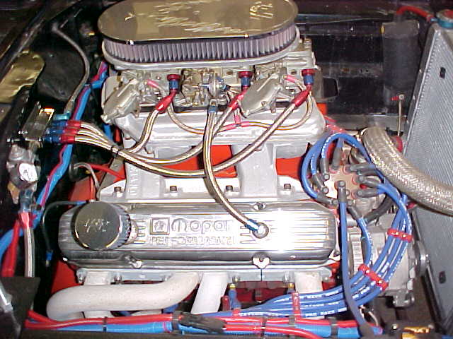

I wanted the best bang for my buck and this set up was it !!View attachment 171235
I can't imagine that works very well at all. Not to be condescending, but those must be a fuel distribution nightmare and probably not very good at low speeds even with the mods. I have one myself but never ran it. Curious to know if it works well for you. I have an STR 14 and a hemi rat roaster and same deal with fuel distribution.
some day maybe I will have one just don't never seem to have 2500 bucks to get one.....I want one just because there bad a$$
Well MEEP-MEEP to be honest it worked very good. I redid the inside lower plenume with the inserts and it had very good street manners. ( with proper jetting and power valves)
But the car was a 4 speed with 4:56 rear gears. And alot of compression to boot !
But an automatic and tall rear gear on a mild motor?!? Your rite not the best first choice !!
