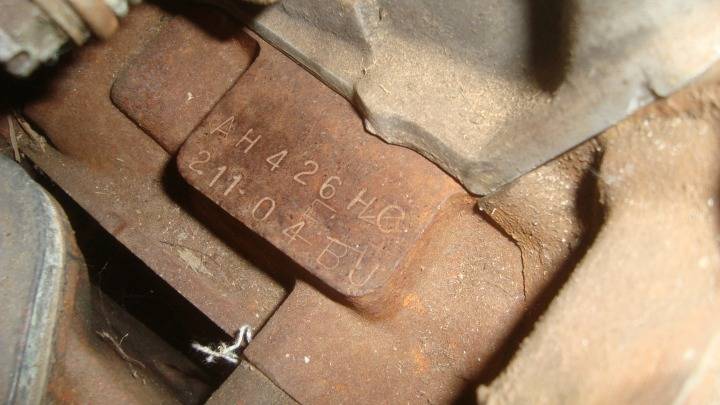

Why is my 426 hemi stamped marine
Actually we located it about 7 years ago now, and did some horsetrading and my friend from Oshawa wound up up with it and still has it.

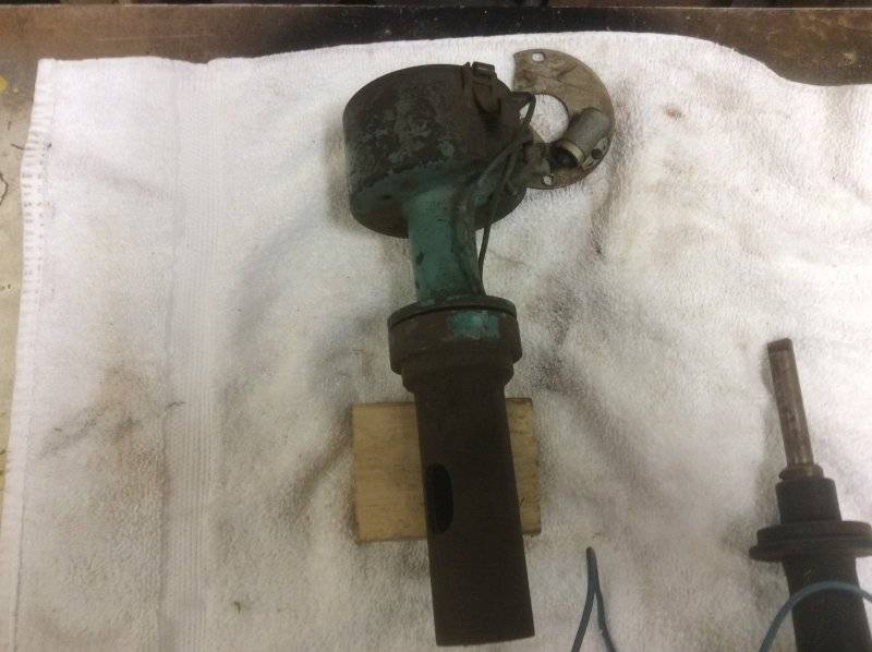

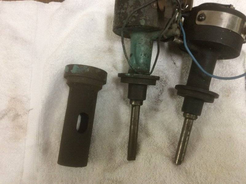

Distributor and parts from a reverse rotating marine 413.Not pictured is the longer hold down clamp.
That's to keep the distributor drive gear from pushing on distributor shaft. The reverse rotation wants to make distributor /oil pump drive pop out cam gear.

We were told by the gentleman with the engine that it was from Miss Budweiser, when was likely from Miss Chrysler Crew as you mention.

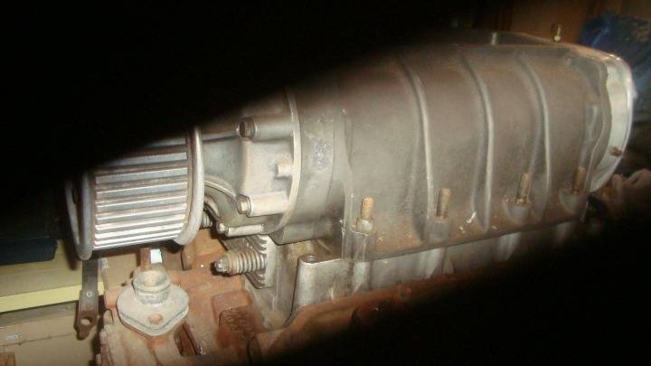

Some pics of the motor.
Mr Hemi...you are in all probabilty correct.

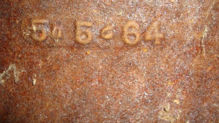

My 65 A990 engine has the same casting date
