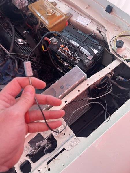

This is 73, which is diff from 74 BUT, colors are the same So posting to use it as colors guide
74 gets two yellows for the starter relay circuit… on cab one of them is traced black… one of them comes straight from ign switch, the other one comes from seatbelt interlock control box. Can’t recall at this moment which one is the one traced. But reversing these is not a big problem. The only deal is you would be bypassing the starting interlock system, just like pressing the reset button.
But get the right harness would be the correct procedure.
