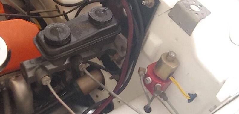

Here is a photo of my master cylinder/line lock. The line coming out of the front of the master is what feeds the rear brakes, there is no proportioning valve like shown in the video.

yes, the caliper bleeder screws are facing up. The master cylinder has only one reservoir under the caps. There is do divider in the master separating the fronts and rears.
My bad I found the text on the photo.
There should be a divider wall it is lower in the reservoir.

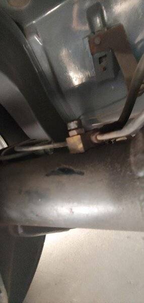

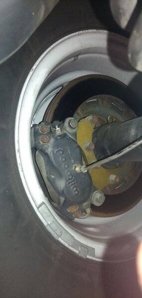

Here are a couple more pics, the brakes, and the piece on the rear axle that sends fluid to each axle. On the top of this piece, there is a "cap" that is very loose, not threaded, but spins easily and feels like it could lift off easily.

Are those 4 piston calipers? If so they have two topside bleeders. Both sides need to be bled on each caliper.
Remove the brake hose at the rear axle and check if fluid is coming through the lines from the front of the car. The rear hose commonly goes bad and can block your brake fluid
There are 2 blenders, in need to take the wheel off to get to the other one. I will also check the lime from the front od the car. Dinner time, so back at this tomorrow.
Is this a new install? Looks to be a Strange MC. It maybe that your stroke is not long enough to engage the rear bias.
I was reading that it (1.032 bore) is for 4 wheel disc with single piston up front and dual or 4 piston rears and a 5:1 pedal ratio. So the pushrod may need to be adjusted a little more ( lengthened)

Yes you need to pull the wheels to get to the outer ones. You should just do one wheel at a time alternating from inner to outer bleeder. Try that on all 4 wheels and see what happens.
