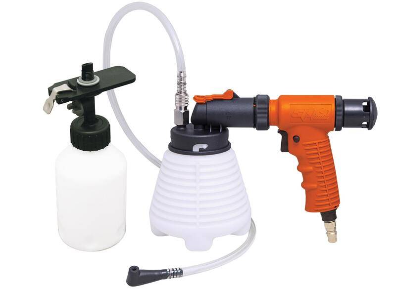

I usually used a vacuum pump, or I'll take a clear water bottle and fill it 1/3 off the way with fluid and take a hoses off the bleeder and submerge it in the fluid. When you are bleeding it, it will confirm that air/fluid is being moved in the form of bubbles. The fluid will turn milky, don't stop there, those are very small bubbles.
