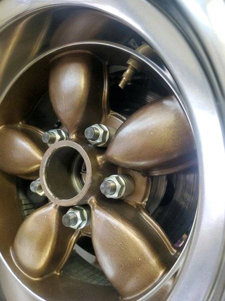

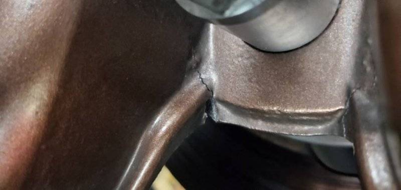

We broke a trans cooler last weekend. It was mounted between the subframe connector and the drive shaft. Under the the drivers seat. Fortunately this kept all the fluid between the frame rails. But was even dripping off the deck lid and tail lights. When cleaning the underside I washed the wheels and took a look at the recently installed 5/8 studs. The picture is the spokes of the rear wheel at the hub next to the stud washer. Every spoke on both wheels is similar. Ran this car for close to 800 passes. Converted to 5/8" studs this Winter. Never guessed the old 1/2" studs were stronger than the wheels.

Glad you caught that. It does make you sit back and think of what might have been. Stay safe!
You've earned your Find the Weakest Link badge for the week.

Hate to think about a wheel coming apart.
I think GTX John had a broken axle that almost did him in.
Heard a noise in front. It was a cracked T-Thrust. Went back to steel wheels and original hubcaps. I like pushing corners, alloy wheels do not.

How old were those Torque thrust?
I don't get the rear wheel photo.....Are you running rear wire spoke wheels ??
No, that's just how it appears at first. The whole brownish part on the left is the spoke. The shadow makes it look like a thin spoke.

My daughter's BF had them all Crack on his D100 race truck. Same same.

Yes !! I've always felt safer with beed screwed steelies of some sort on powered axles (usually rear).... Lightweight allow fronts have worked perfectly so far...
