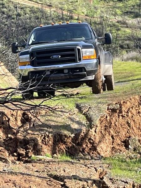

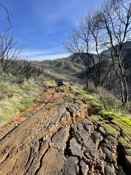

I got up there a couple of days ago and after getting past my problem areas I found a massive slide (by my standards anyway). It is basically about 50 yards long, and at the top it has slid down about two to four feet.

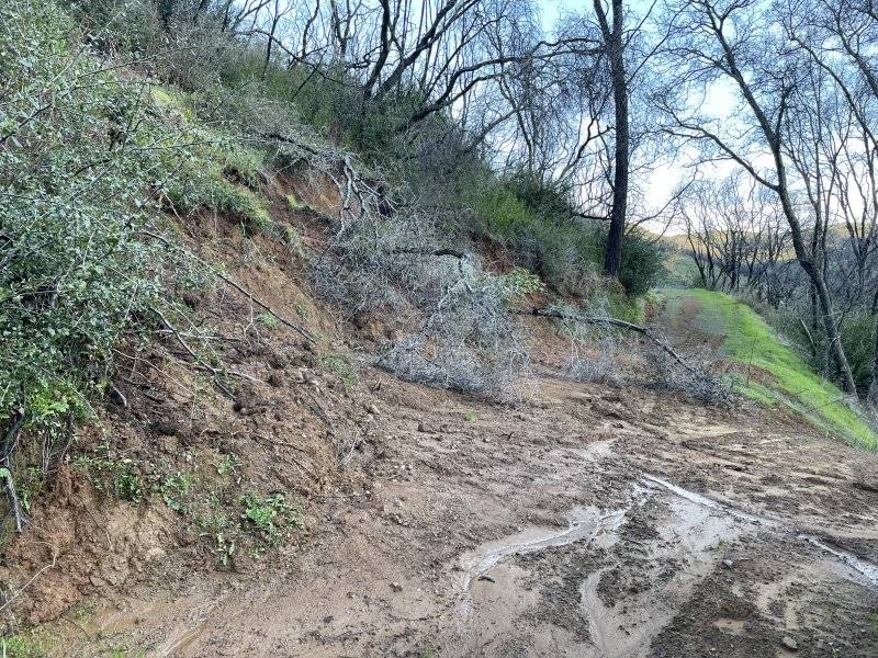

It is hard to describe, but directly below this area, maybe 40 yards, down a pretty steep hillside, is a switchback in the same road that was partially blocked by a slide. I am assuming it was the same slide, which would mean a big chunk of hill is moving. This is the lower switchback looking up the road that goes to the big slide.
