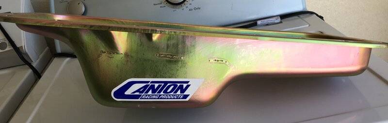

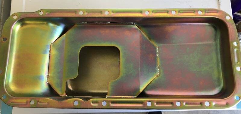

Hey guys.

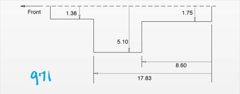

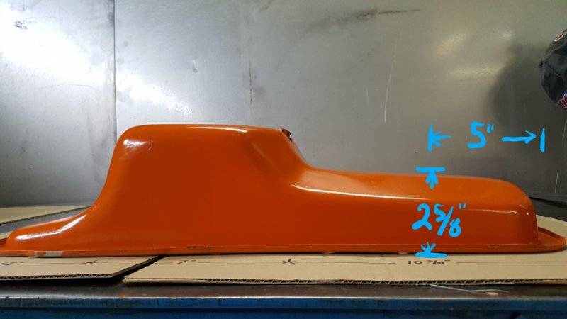

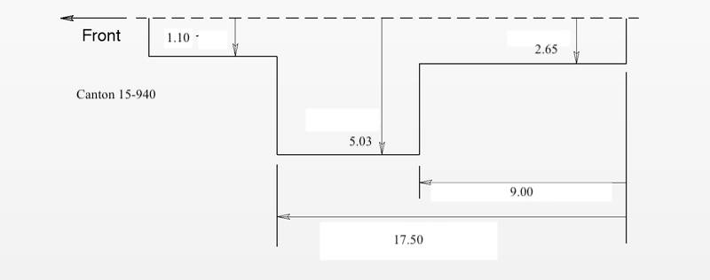

I picked up a oil pan for relatively cheap hoping it would have the same dimensions as a #971 or Moroso 20765. Turns out the dimensions aren't the same. I'm hoping if one of you Mopar wizards will be able to tell me if I can use this pan on my 440 that's going into my '65 Satellite.
Thanks All!!

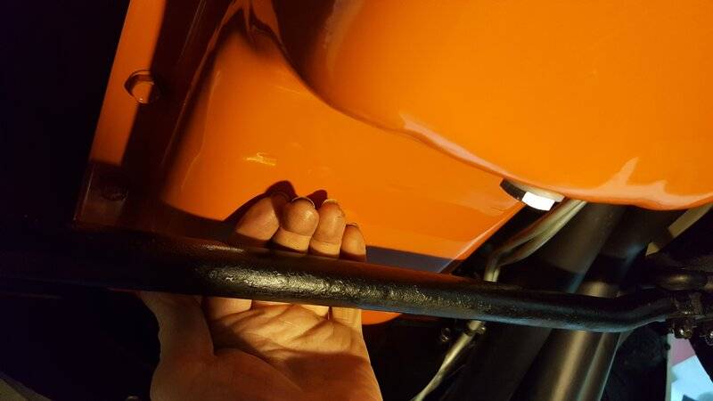

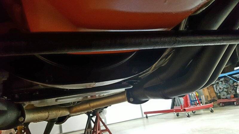

I'm not exactly sure how close the '65 is to the '62 but this one was just starting to rub on the center link. The 2-5/8" measurement is too close.
The 971 measurements and after I installed it.
