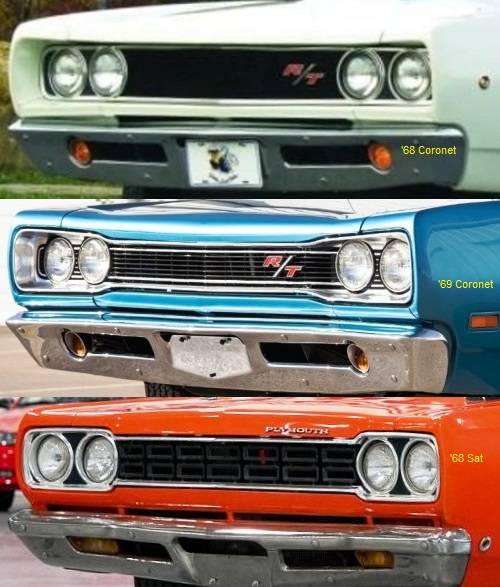

Belv/Sat/RR hood would bolt on, "fit" the cowl, and run parallel along the fenders -...but latches probably wouldn't align and I'd expect some crashing/big gaps at the grille. Coronets have upward fender and hood contour at the front that others don't; '69 is pretty subtle. Even a '68 Coronet hood isn't going to be "right" at the grille for a '69 - '69 grille shape is a one and done.

@MelroseMopar - made you a quick composite. They're all quite different and it's easy to see like this.
68 or 69 Coronet plain, bubble or Ramcharger hood are the only fits. 69 uses a hood extension lip to fit the grill detent.

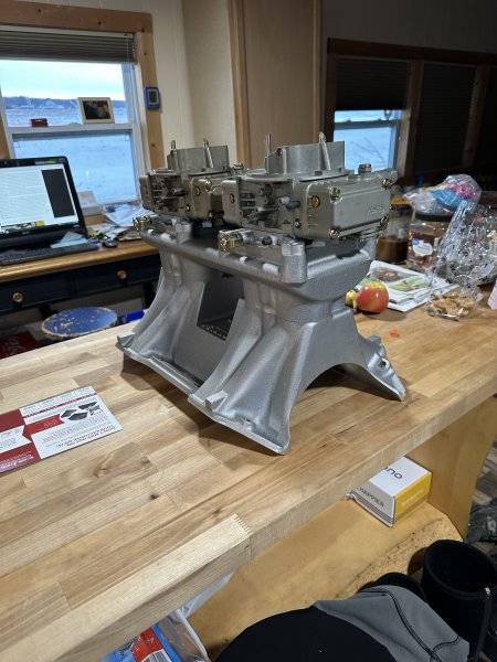

I decided to go with dual quads on a tunnel ram and I’m looking for an old beater hood that I can cut up, looking more and more like I’ll just have to bite the bullet and spend 800 bucks on fiberglass.(yes, I’m keeping the A
12 hood.)
Truly, thank you everyone that replied. Has been one of those you don’t know what you don’t know until you know you know? Kind of posts.
