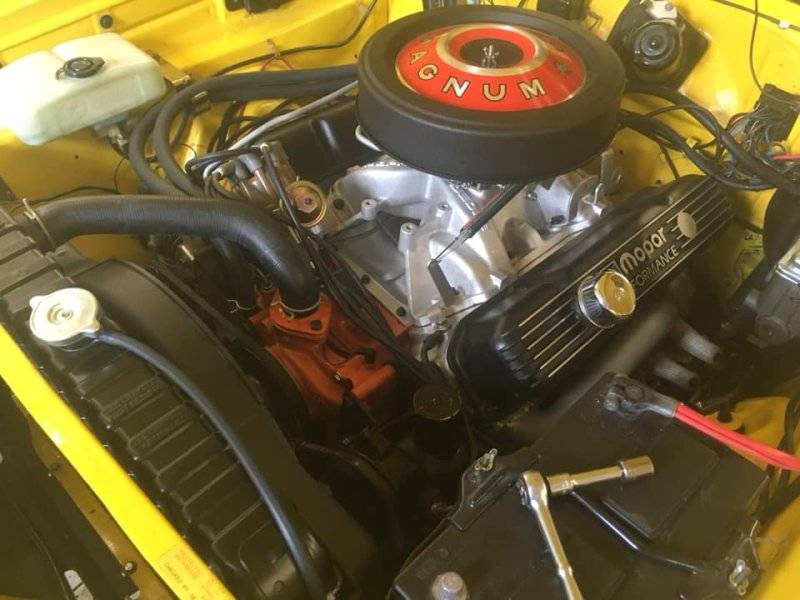

I run one in my 68 Charger with a 505" 440 in it. You will need the drop base from mancini to use the stock air cleaner. In the 383 you can get away with a shorter filter, but in the 440's case, its taller, so you need the drop base.
