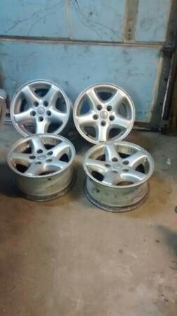

Will these fit on my 67 ' coronet? 15x7 5x4.5. Was wanting to run slicks on them because their cheap and I need wheels to put them on. Will these fit without problems? They're off am 05 Jeep.
They should fit, you may have a problem with the front tires hitting the frame before lock to lock steering.
They do have a lot of backspace just from the look and knowing how newer cars are designed these days.
You may not like the look from the back on a Coronet, they look better with the wheels out as far as possible.
Just my opinion...
