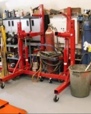

See photos. He say it is 2200lb from KMS tools.
Will this fit my car?
Any modifications or is it pretty straight forward?

The bare shell I'd say yes.
Should do. Just need to make your front and rear mounts.
Thank you. Yes I was assuming the bare shell. Was only concerned about the length overall. I see many that fit Chevy's that pull down further than the Mopars with only the firewall left once stripped.

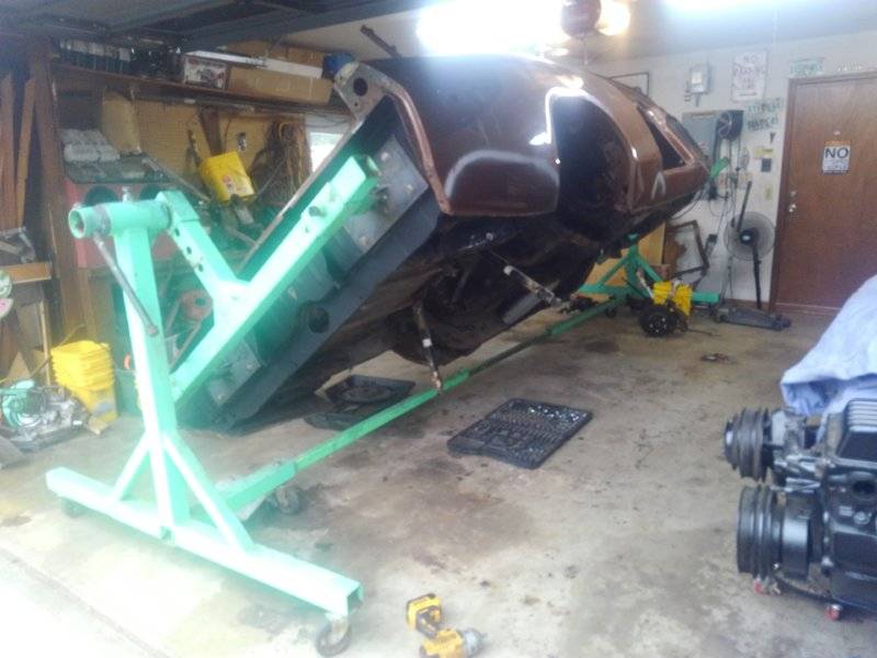

The overall length is governed by the adjustable center tube. Measure to be sure.
There is nothing about that unit that can't be made to fit the GTX. You'll probably have to fab the rear mounts (I have measurements for those). The center tube is a non issue - just get a longer tube if necessary. What's the asking price?
You can make it fit if you have to.
The rear mounts are easy. The front mounts you can buy from Auto Twiler.
The rear mounts are just 1-1/2" angle iron.
