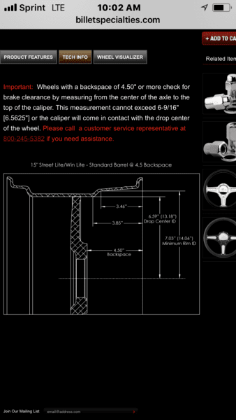

Anyone running these brakes with 15 inch Torque Thrust Ds? Some people say yes others no.
You need to see how much clearance is needed for the caliper in the kit you’re looking at. Then measure the caliper clearance in your wheels. Wilwoood has diagrams on their site to refer to.

Good to know. The issue being the 45 degree taper from the wheel face to the outer portion of the wheel.

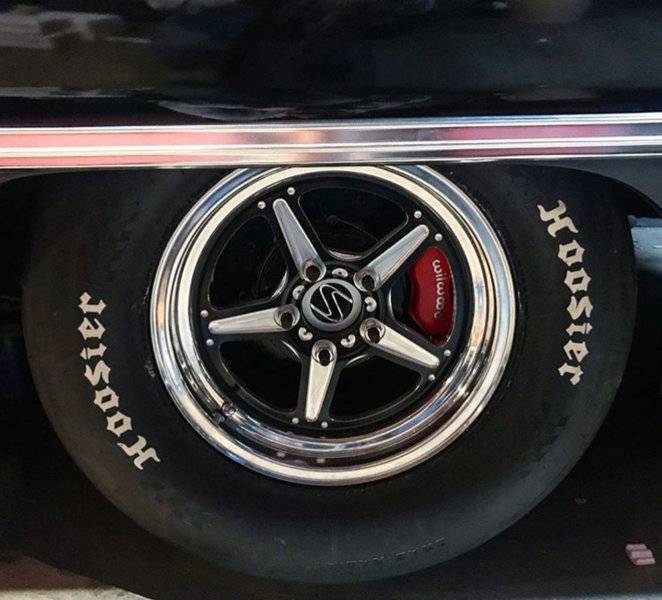

Does anyone have a set they could measure from center of hub bore to inside of drum to get the caliper clearance? I have those mounted on 15x7 street lites and they barely clear
Those are the 12.19 brakes? What does the inside of your wheel look like? Could you measure your set up?
No issues with that inner bevel?
No not on the 15x7 with 4.5 bs 15x8 with same back space moved that step down on the inside of the drum closer to the caliper and was running but a spacer easily took care of that. I have a nice set of billet .5” spacers if you need them.
