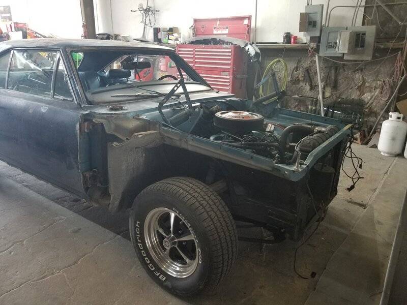

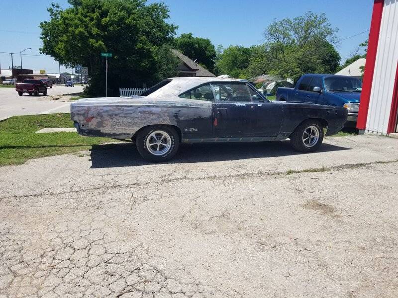

I upgraded my 1968 GTX to Wilwood front disc brakes. I put 15 x 7 American Racing Magnum wheels on the front and 15 x 8 on the rear and put the bullet
center caps on in place of the ones that came with the wheels. Works great.

I bought the American Racing Magnum wheels because there was no concern about the backspacing for the upgraded Wilwood's. I have had no problems at all with mine and it is a daily driver(weather permitting). Ill try to upload you a picture.
My car is being painted right now.
What color are you going with ?
Do you know which Wilwood brake kit you used ?
The car is a matching numbers 1968 GTX. The original color is UU1 Frost Blue metallic, which is what I'm having it painted.
I will try to find my info on my brakes, but it's been 3 years ago. I went to 15 inch wheels and the conversion kit I got had black calipers.
