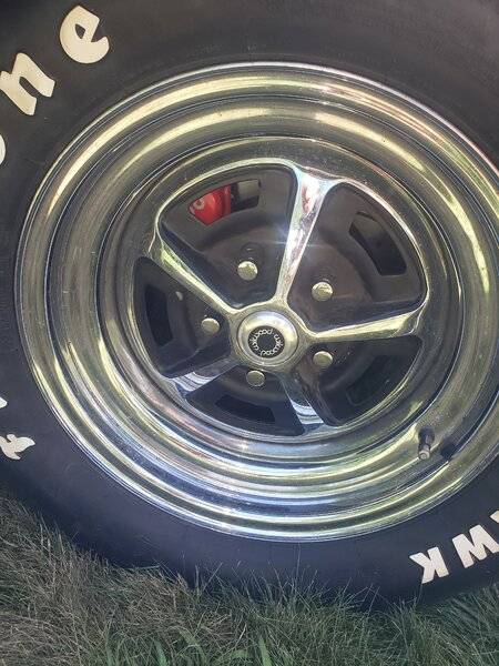

Thank you for your help. I decided to buy the Wilwood kit and before I have it installed I am going to see if the nose of the Wilwoods will fit with my magnum wheels. I can do this with out taking the hub/ Nose piece out of the plastic bag. If I have to remove the bullet caps for them to fit I can live with that. If they do not fit i will return the kit to Summit.
I will give an update as soon as i know.
Again Thank You all for your help.
FYI. When I purchased new bullet caps I had to grind the ears down to make them fit. You may have to do the same but it should work fine.
I got my Wilood brake kit installed and the only problem I had was to remove the center caps and I can live with that. I actually think it looks better.
I want to Thank everyone for their help it was and is greatly appreciated !!
Looks great. Glad to hear it worked out.
Just curious. I bought new bullet wheel caps for my car when I converted to Wilwood disc brakes from Classic Industries, product number MD2307. I had to grind the ears down to make them fit on the backside. Just FYI.
Hi Paul , Thanks !! I was happy to see they fit. Did you have to use spacer behind the wheels to make them fit ? Because it doesn't look like I have enough space between the wheel and the Wilwood hub.
I did not have to use a spacer. I pretty much just ground the ears down on them to where it would catch good enough to tighten the holding screws down. I've had no problems with mine at all. If you look on Classic Industries and check out the part number I gave you'll see the ears I was referencing.
My wheels were American Racing Magnums. My Wilwood calipers were black, but your red ones really look good.
I know the ears you are talking about so I will have to grind them down to see if I can get them to fit. I am sure they will since it worked out for you.
I think next summer i will put disc brakes in the rear.
Thanks again for all your help !!
