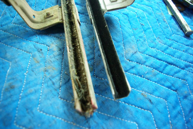

ok.... the 62 is getting close to done. but need some info on the window channel felt. it gose in the rails that the door glass slides up and down in. there is nothing left on any of my 62's to match up with. so what do i need? and where can i get it. thanks.
Joe Suchy has it. Comes in a roll and has to be cut to size. I used plywood strips to simulate the glass for gluing. Don't get crazy with the amount of glue.
Mike
I used the soft side of industrial velcro and weatherstrip adhesive.. i think kryslerkid here had posted it and it worked great...
I bought it by the roll with the adhesive on it. Wet the sticky side to get it in the track and then trim it.
I got tired of the window rattling when it was up so I used the Velcro like @icetech did only I just put it in the top of the channel. Not a permanent fix but the rattle is gone.
