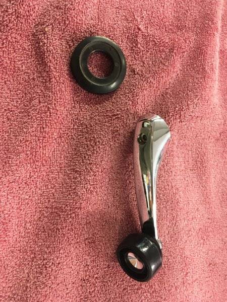

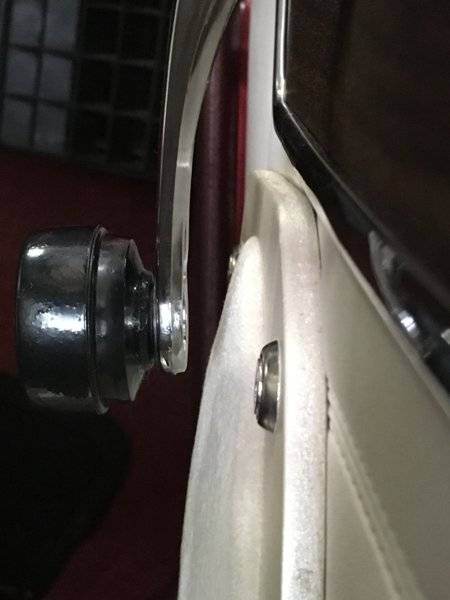

Check out the late model car & pickup truck cranks on eBay. Brand new, something like 1” more clearance, nos and only about $10 each. And they’re Mopar. I countersunk the speakers in the door and made custom covers.

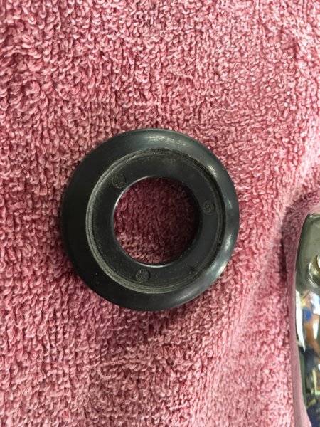

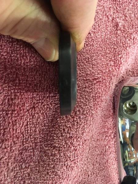

Window crank #3882765, it’s a 1” total clearance. The black plastic spacer is 5/16” thick and I can’t remember where they can from. Didn’t come with the handles but may be what was used.

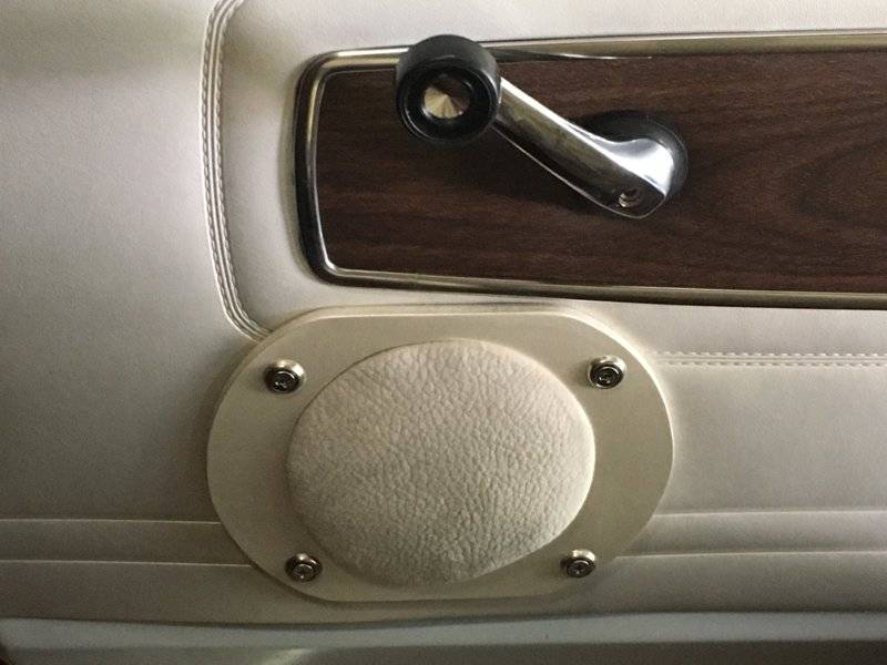

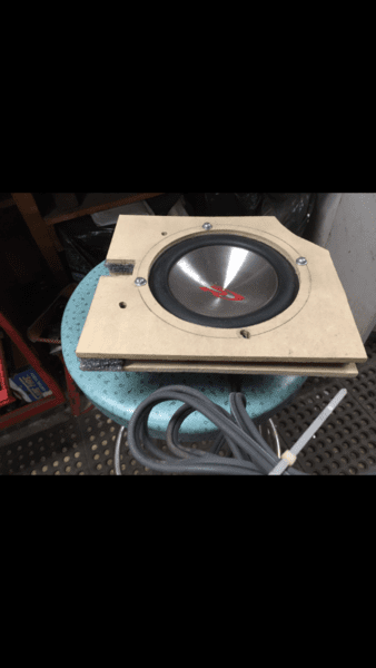

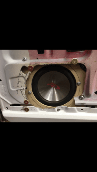

Speakers were made from “premanufactured wood” or something like that. Got it at Home Depot and sold in small panels. 1/4” is very sturdy and I squeezed the speaker between 2 pieces for rigidity. Speaker grill is same material, I cut it oval because it looked good. I used the original speaker grill’s metal grill (lost the plastic frame) and countersunk that in the hole. BUT first covered it with material from Hobby Lobby. Look for something thin. It took a while but (and Thanks) it blended in very nicely. I had to redo mine until I was satisfied. Good luck.
