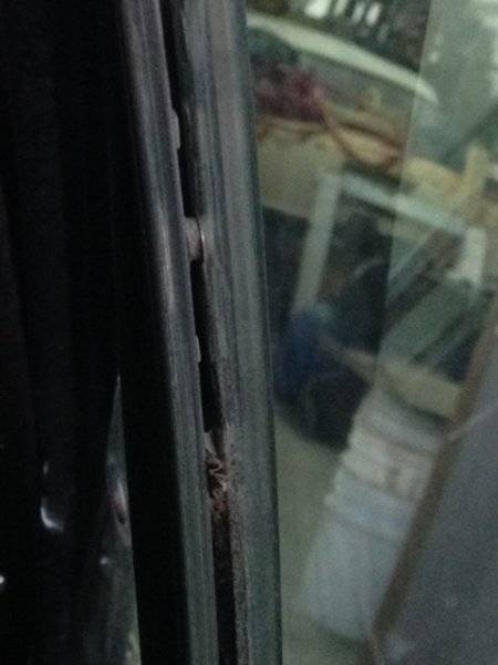

I'm looking for suggestions on how to fix this. The pass. side window will roll down a couple of inches and then the plastic guide binds on the bunched up seal in the vent wing channel. This is on a '68 Coronet hardtop.
Are they new or original?
Either way since they "bunch" up they have to be replaced.....
If new, most people use the new holders with the new strips...makes sense but causes big headaches. They are thicker and taller than the originals....I always reuse the original holders and never have an issue...Punch out the hole in the strips with a hole punch and line up the strip correctly so when the glass is all the way up so is your U strip.....I also soak the "U channel" strip with silicone interior detail spray and then install...
Last but not least the next important item is proper window adjustments....
Everything is original. This car has been sitting for 15 years. I lubed all the other windows and they roll up/down like new now. You can see in the pic the plastic slide and below it is the bunched up weatherstrip. I don't see how an adjustment will correct that.

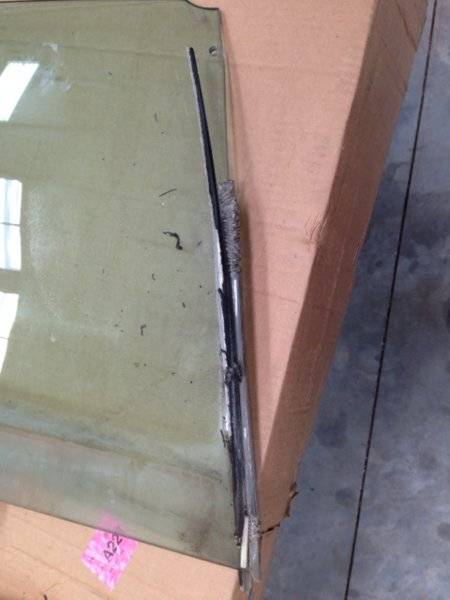

OK, I got it out, it was bunched up pretty good. I couldn't find the replacement seal on the Megaparts website. In fact, the only place I found it is here:
http://www.ebay.com/itm/MOPAR-Door-Glass-Vent-Window-Channel-Seal-KIT-Coronet-Superbee-Belvedere-GTX/321683683263?ssPageName=STRK:MEBIDX:IT&_trksid=p2055119.m1438.l2649
$100 seems very steep for this part. Is that the going rate? Does anyone have a part # so I can do an internet search?
http://www.megapartsusa.com/proddetail.asp?prod=123-WS230
As you can see thats what they run.....from 100-145......
The original Chrysler piece has just recently went NS1 to my understanding. When purchasing these pieces, make sure to know if your purchasing original Chrysler in the sealed carton or the reproductions. Huge difference in price as we sell both. As Justin mentioned earlier, if you purchase the reproductions, reused the original H-pins or you will have to massage the reproduction pins as they are too thick which will interfere with the operation of the window.
