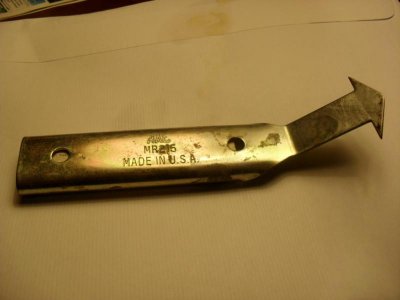

How do I take the trim off around the front and back windshield?
Without bending them ?
You would have to get a windshield removal tool. I don't have one to get you a picture but it is shaped like a "Y" with little hooks on each end. I took mine out with a small screwdriver and pried them up. I got lucky and didn't bend them.
