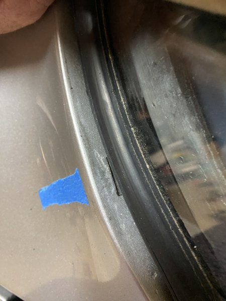

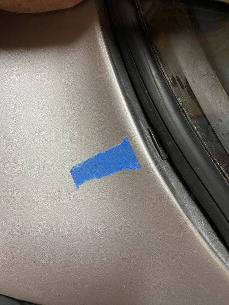

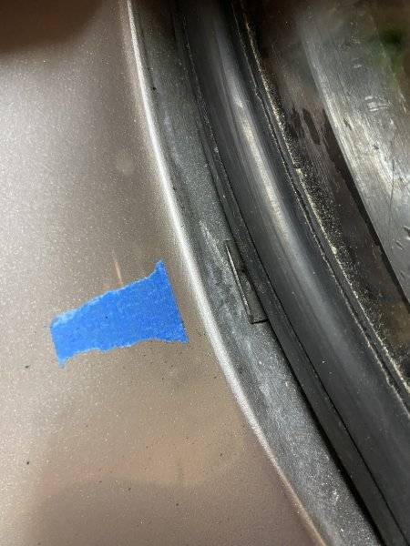

Hi on my 68 Charger I have 3 on each side
8 across the top 9 on the bottom, I was not impressed by the “ Authentic Mopar” repop clips very bendy they don’t spring back, as I found out test fitting trim to them , if you bend them back they snap & break , luckily I saved a lot of the originals ,I was short about 6 so I spaced them apart, so at least I have one between the monkey metal, also the screw heads are larger than original , which made the F bombs drop ,I hope this helps you Cheers !!
Thanks for the replies. I noticed some cars have 8 across the top and some have 10. I just wanted to make sure my body guy didn’t put in any extra.
