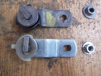

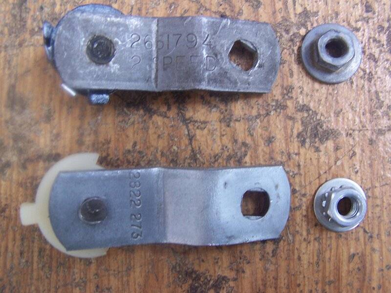

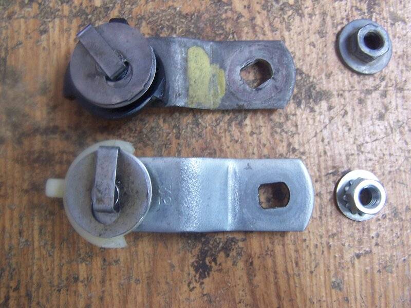

I just checked Mega parts inventory. They have the 3 speed arm but the bushing is on back order. Mentions 68-up so probably the same crank arm and bushing used on 68-71. I know the crank arms and bushings are different between 2 and 3 speed. They are clocked different and the off-sets are different. Here are a couple pics of arms I have. Not for sale though.
3 speed arm is a bit longer with a 3/8" off-set while the 2 speed has a 1/4" off-set and the clocking is different as shown.

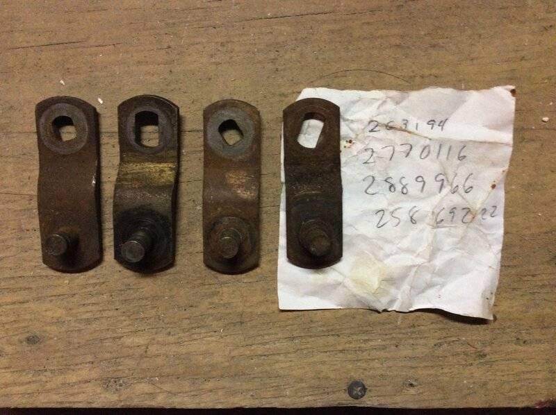

Here are the cranks arms I have, part numbers are in the photo. I may have a few bushings too.
