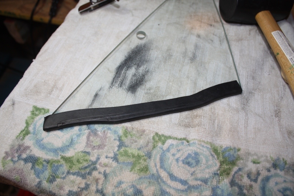

If you have the factory glass, you need 1/16" glass setting tape. Not the 3/16"!
If you take a caliper and measure the gap in the rail then minus the glass thickness, divide that by 2 you get the thickness required - 3/64". I am unsure of where you found the 3/16" in my post?
1/16" will work but you will need to put excessive pressure on the glass to get it to seat due to the extra 1/32" of material. The 3/64" material required a fair amount of force to seat it and has been working very well for me.

So I have a couple of things coming to try, the 3/64th" tape is one, I am wondering how that works do you just center the glass in the middle and fold it up around each side and drop in in the channel? or do you fit it to the channel then wedge the glass in? the product come at 1.5" wide 3/64" thick so centering the glass at 3/4" would be the middle? that should be more than I need when it sits in the channel just cut off any excess flush? the other stuff I wanted to try and still think it could be repoped are these fitted rubber channel just with out the exact right size its a trial fit process. I also have some steele rubber products sash stuff at 1/16" thick and 1-1/2" wide so I can compare and see. I think you guys are super close to the exact fit part we will see. Also hope this post helps someone else down the road. I forgot I have a few pieces of the original gasket left I will measure it tonight.

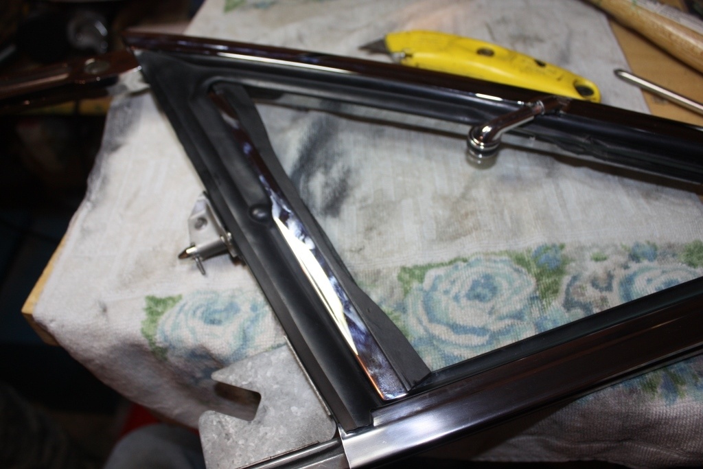

Assemble the window into the frame before trimming. You may have to move it around a bit for proper fit.
I used the utility knife shown to trim the extra once I was happy with the fit.

There is compression to account for. 3/64" would give you little to no compression. That's what holds the window in. 1/16" as stated would be the right thickness.
So the 3/64th stuff worked, other stuff as too thick for sure and the pre made track stuff I got would have worked had the base been smaller. I think the pre made channel stuff would be perfect if you can find the correct size. the universal glass track tape at 3/64" that web site that does the math for you is right on the money. now I have a roll of the stuff if anyone needs some strips lol now whats the trick to getting the new frame gasket installed?!! man this thing is kicking my *** whats the trick to getting it in the right place? mine almost seems too big!
