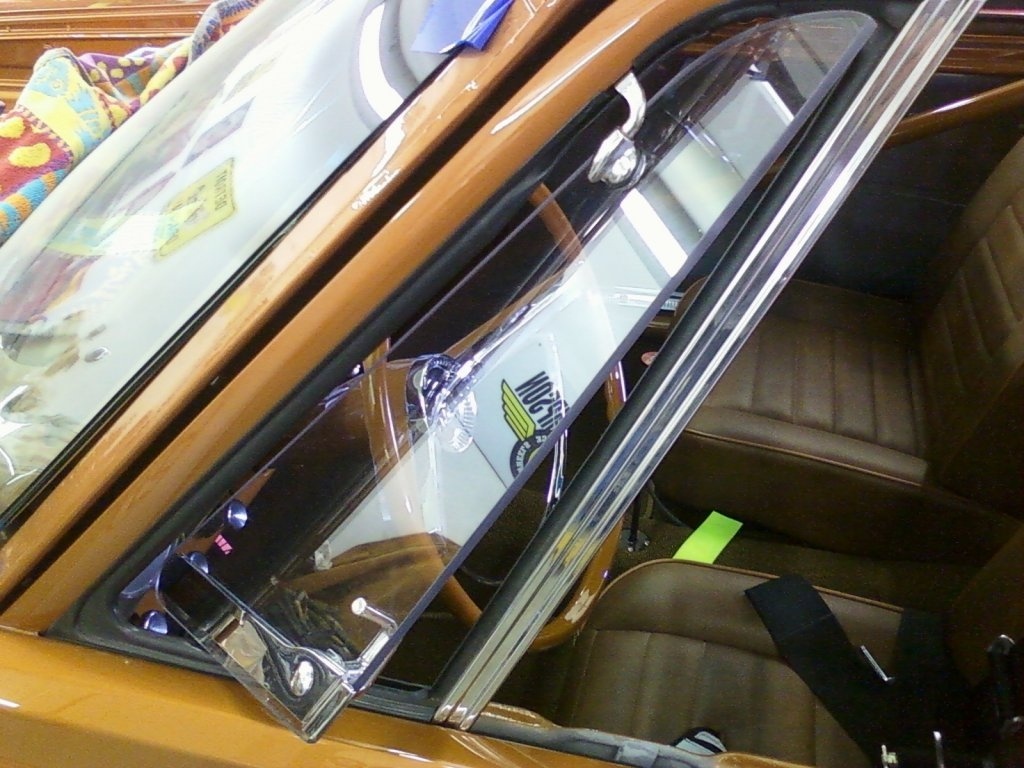

You may have to start with 600 800 then 1500 before you polish. Post a picture here so I can see if it's as bad as mine was. I went back to look at your picture and can't really see them and from what I can see mine were worse but Take a close up of the area and repost it.
This is on a 69 hemi charger of a friend of mine. I cant get any pics at this time.
