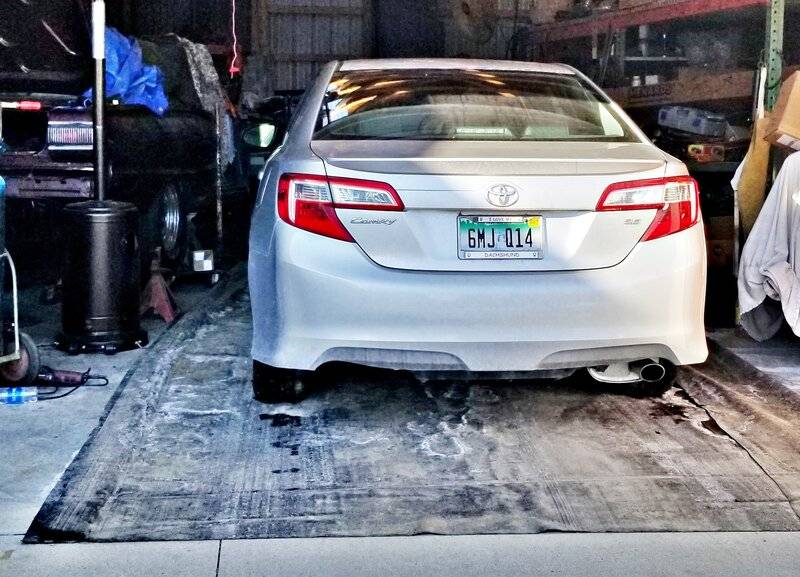

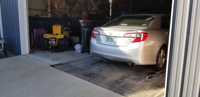

Hello I have made a nice way to keep out the road salt and water mix from my garage floor in the winter.
My wife uses a portion of the barn in the winter
I bought a new thick heavy duty flat roof rubber that I bought at a roofing supply in my area.
The rubber is 20' X 12' and cost of about $200.....and weighs about 80lbs.
I have had it down for several winters now and it keeps all the road salt and water mix out of my barn.
I can pull out and pull it back in fully opened myself and back in....

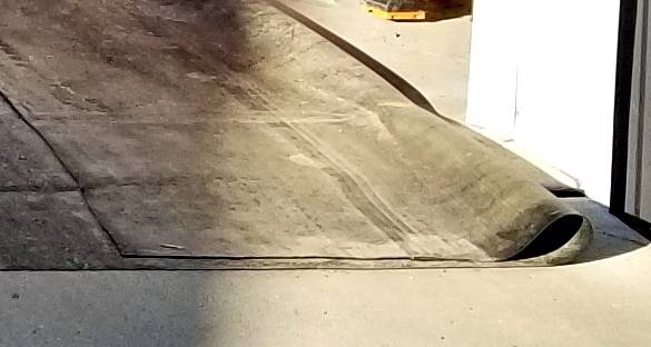

I roll the mat up like a rug and folds over into a small square for storage.
My tractor with chains put a couple holes in it and I repaired in with a flex-seal patch in the winter.
it seals instantly on the backside in the winter.
no dry white salt crystals in the cement cracks.
The heat from the car + the black mat almost instantly turns the slush mixture to water... and is removed with a broom-squeegee quickly.
even when its below freezing temps (15 C degrees)
Just flip up the sides to fit your size car and the water stays in the middle.
dont know how well it would work outside the barn.
The mat is durable from my stand point.

My garage can be heated.... but is not.
Any airborne salt so far has not created any rusting issues on bare sheet metal inside.
The key is keeping the wet salt solution pushed outside daily and allowed to dry.
(I have big over head fans for that)
going on the third year i can confidently say i am happy with the results.
my wife's car when she goes to work is clean of all frozen salt solutions and dry.
The outer outside lip of the mat keeps it from reentry..... its all down hill.
I was considering selling this idea but my remaining years must be used to complete my 67 coronet.
if one was to make a larger mat I think it would be less manageable and harder to dry.
By using clean dry silica sand lightly under the mat makes it easier to slide in and out.
the same mat can be made wider be simply by making the side folds smaller.
I have had my 4x4 Dodge diesel fits OK if its opened up to the widest position.
NO salt brine in my barn....!
