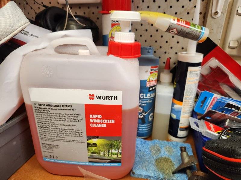

Seriously - have you tried the Wurth brand of windscreen fluid? I use it and it is awesome - no chemical reaction on paintwork, and it helps to keep the lines (tubes) clear and clean.
I got my buddy to get me a 5 litre (a bit more than a Gallon) bottle of it a while back. All the regular crapola like Bars Bugs is crammed with Chlorine and detergent which eventually corrode bodywork, and stain paints....also rust out the wiper arms.
Wurth fluid is orange in colour.

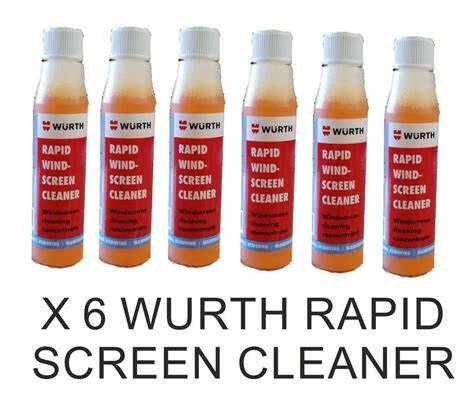

Picture below shows the retail 'one-shot' bottles that most Mechanics will sell you - but it is cheaper to buy the big bottle with a pump dispenser.
Two threads with one picture.... this is my big bottle....smaller capsule is to catch the drips from the pump.
