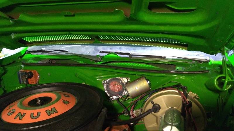

Does ANYONE know the size nuts and threads for the 3spd wiper motor to arm on a 71 B body and the 3 nuts that hold it to the firewall??? I've been Googling these damn things for 2 days and have come up with nothing but motor themselves and mostly 68 through 70. Appreciate any help
From memory they will be 5/16" UNC
Check if a 1/2" socket fits the nut...then that is the case.

And since no one else mentioned the nut attaching the bell crank to the motor varies, most are 5/16-18 like the wiper to firewall nuts... But some are 1/4-20..
Yep. Usually a 1/2" socket can remove the wiper motor nuts, the crank arm nut and the wiper pivot nuts.
