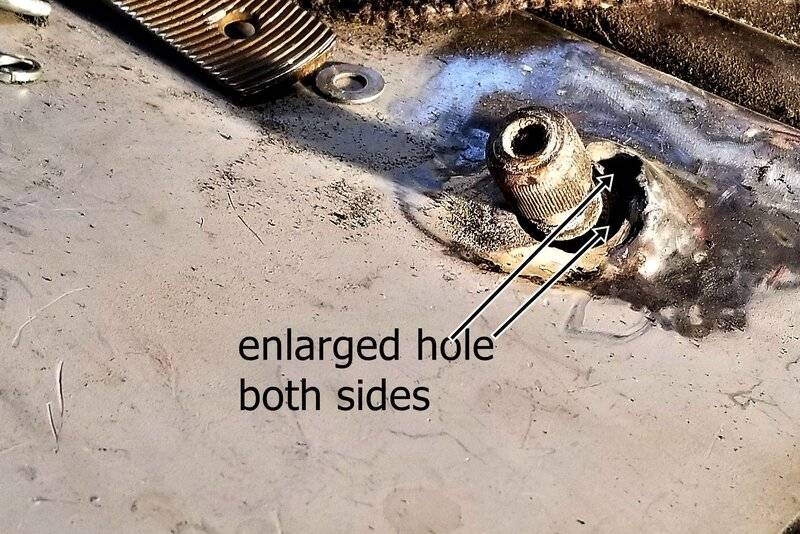

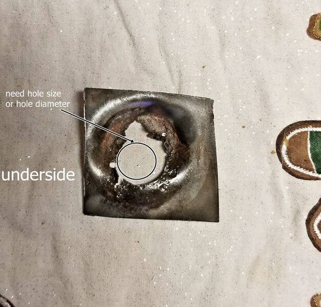

My wipers 67 coronets pivot assembles seem loose look now as if they moved sideways and have caused the external sheet metal damage. (see pictures) elongated hole
Was this because the pivots were not tighten properly or because the motor gears were not clocked properly?
Also can that repair is done externally??....... is there a gasket of some type that goes between wiper pivots and sheet metal in picture?
Any help would be appreciated............

That looks like Father Time has taken it’s toll, from the picture. Suggest you look under the dash and see if the pivots are bolted in securely. If those pivots moved that much, can’t see the wipers functions very well. I think you should track down another cowl. Don’t know how much you want to put into the car. Good luck.

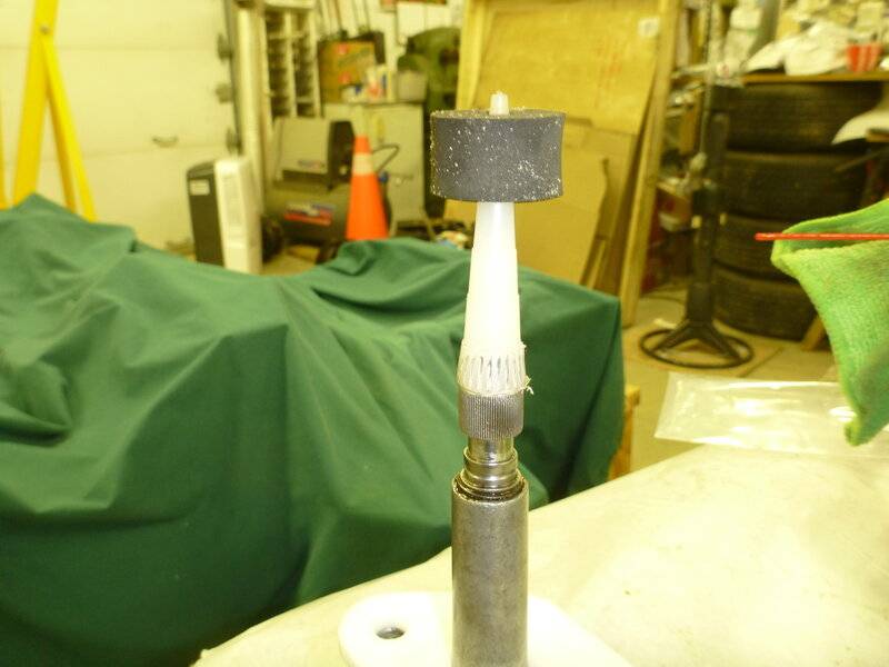

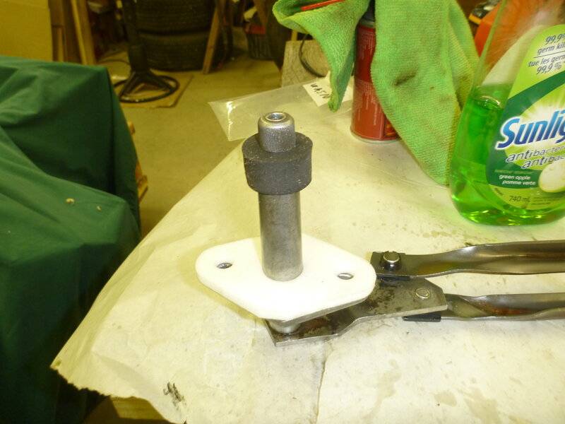

Yes, you have a wiper pivot seal, and it's definitely not going to work on that.
My next move is to track the movement... and repair....... if there is a will there is a way.
Thank guys....

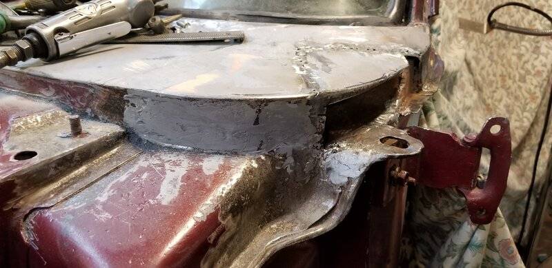

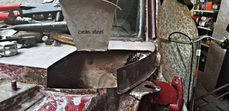

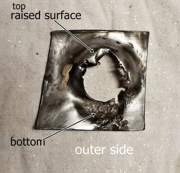

OK.... I cut the worn part out and is as pictured.

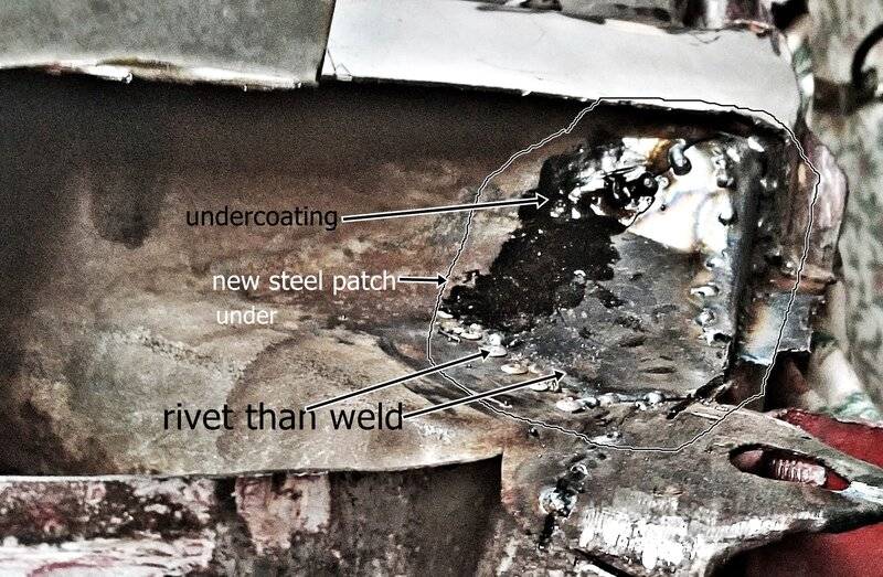

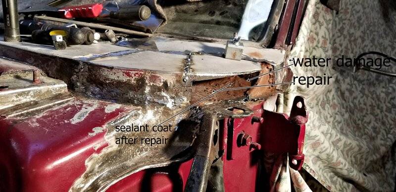

I also had a rust issue on left side so I cut the bad part out and riveted then welded and sealed with my special sealer I made. All the wires & insulation were in place with no damage after the welding.
I am in the process of welding the left corner back....
I need the hole diameter and or a photo of a undamaged outside so I can make one for the wiper area. Thanks
The left side wiper pivot is loose and the right side is not.
I would like to see a picture of the gasket that goes between the outer sheet metal and the pivot extension thats peering on the outside of the wiper hole.
What is the steel holes diameter please...... there must be some clearance points between the pivot shaft and the top sheet metal hole. I thank you all..

Not to be funny but the hole diameter should be the same as the passenger side.
