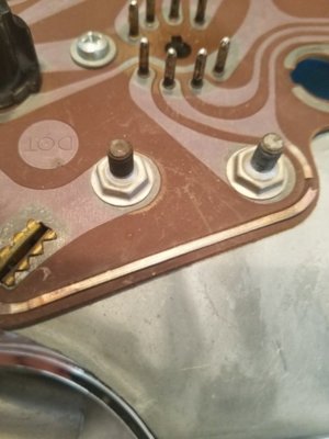

Has anybody used wire glue? This is supposed to be a heatless alternative to soldering. I've done some sifting on wire glue and for the most part, the reviews are positive. The gas and temp gauges are out and finally discovered a broken wire trace on the circuit board. It's the sort a situation where heat soldering could create other ills so pondering on this approach before I end up heat soldering or buying a new board.

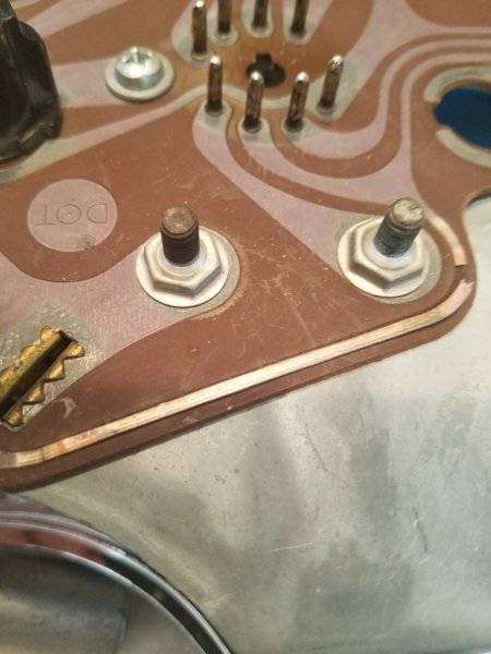

Thanks guys. The wire glue stuff is filled with carbon fibers I gather and takes a hard set after several hours as I've read up on this stuff. The de-fog kit you mention...does that take an adhesive set I suppose? I inserted a pic of my damaged circuit board FYI. The entire discolored section of the trace wire uprooted itself from the board and part of the wire split so have a gap there. I imagine will need to super glue all that unless the product you mention takes care of that.

You've got the right stuff. It's an acrylic 1-part air dry with copper......literally, nail polish with a bunch of copper in it instead of red/pink color. The copper conducts electricity. The stuff works. I highly recommend that if you have any cracks in the board itself, to lay maybe a single layer (2 max) fiberglass patch on the back side of the gauge cluster (the side with no electrical circuit) where needed. Then you just clean/dry the damaged section & bridge that gap with the copper "nail polish"
