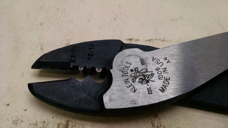

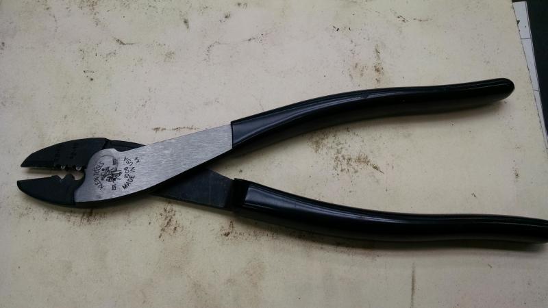

Thanks, I tend to agree with you. Could you show me what a Klein tool looks like?............................MO
Klein 1006 is what I have been using.

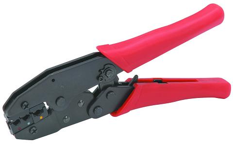

If I have to crimp, I prefer this style of crimp tool. Good even tight crimp and wont tear the insulator.
