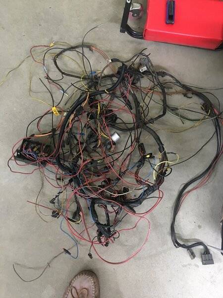

Good luck and take your time! Get a plan for each time you get down to work on it. Makes it much better. Trying to do too much at a time can get crazy and sloppy! When I did mine, I worked on it every Monday and Tuesday’s (mostly Mondays) then rest of the week I would prepare for the following
Monday’s / Tuesdays. Worked out well. One could go a little more frequently, but my schedule at the time wasn’t good so was about all I could squeeze in. Take plenty of pics before you start! Also of each system that you’re about to work on. It helps!
This is what it looked like after night 1!
