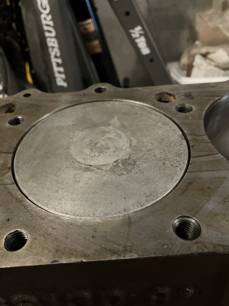

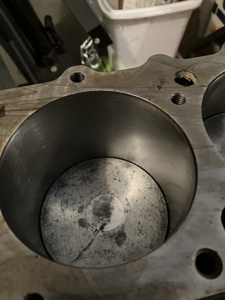

Hey guys, I have an opportunity to buy a rebuilt 1969 383 .030" over, and seller is stating it has 10.5 to 1 flat top pistons.
It's just the short block. Rebuilt 10 years ago and stored well. No machine shop paperwork. What do you think it's worth? Thanks!
Did the owner state why it was built no further? I bought a long block 440 for 250.00 But I knew it had to be blown apart and rebuilt. With no paper work you won't know much about the block other than it has flat top pistons... You don't know if it has been magged or 0 decked or what they did to it. Probably to me worth around 400 to 500 bucks.
Yeah sadly if you can't come out with facts, it's hard to instill confidence. Even if I hear it's built by so and so, that might help if you know them.
I would want to
Research the piston
Measure deck height
Check a main and rod bearing shell
500-1000 depending
pull some caps look at the crank and bearings. Was it balanced? Look at the rods and pistons from the bottom.
If a B engine is decked the stamped numbers on the top pad will be gone or thin.
zero decked is not always necessary or a good thing depending what you want In the compression Ratio.
Thank you all for the responses!
I think I am going to pass on it.
I don't have enough information to offer anything remotely close to seller's asking price - which is over 3 times the price @3white74 paid for a similar 383 short block.
I just found this on your local Craigslist. I didnt read it. But its a 440
And Another 383 here
I would never want to run a short block that was built and sat around for 10 years. Piston rings do not like sitting in one place for that long.
You made a wise choice in passing on it for more reason other than the cost. It would need to have been torn apart anyway before I would have ever used it.
