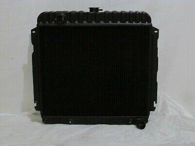

The problem with a copper/brass radiator these days is crappy chicom copper and smaller than 1/2" tubes (factory was 9/16", max cool was 5/8"). Meanwhile the aluminum rads have 1" or 1-1/8" tubes.
These even have mounting studs for a shroud, will try to see if the factory 70-73 shroud fits tomorrow.
https://www.ebay.com/itm/Mopar-Blac...521de3811a:g:L9UAAOSwjgZc~qTT&redirect=mobile

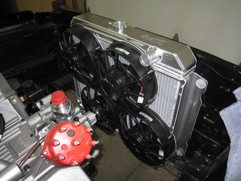

As I have stated in previous posts here, I purchased a Wizard radiator (22") with 4 Spal fans (staged) to cool my 540 Indy motor with A/C. Wizard says it will do the job but, I have yet to complete the build.

I checked the ACC rad against the factory 70-73 B/E shroud. It's close but not exact - mounting studs are 23" x 14-3/8" vs 23-3/4" x 14-1/4" on the shroud. If I open up the slots a bit, it'll fit well enough. Even the tank recesses match up. It's a nice radiator, I'd be happier if it was a true 100% bolt in but overall it will work and look stock at a glance.
The shroud that I have is a repop, not sure if originals are spaced a little different. Mounting hole locations should be the same for earlier B-body. A-body shrouds are 22" x 13-1/4" and look like you wouldn't have enough overlap on the flange.
