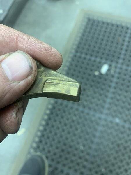

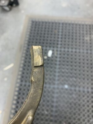

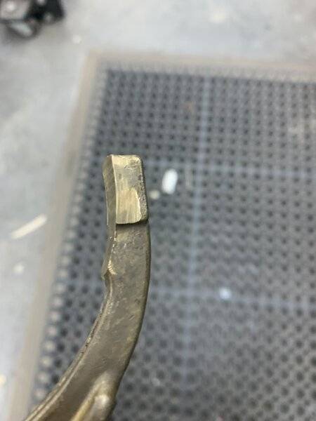

Does the wear on this shifter fork look like it was caused from improper shifter adjustment?
They're the early side cover style and they just wear. Replace them with the newer model side cover steel ones. You will have to cut the nipple off the end but that's no big deal.
