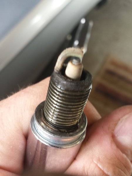

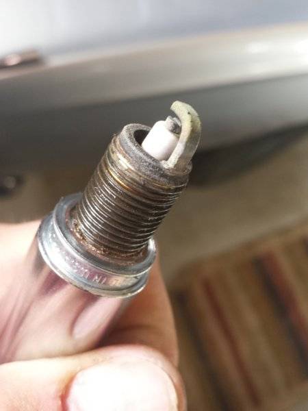

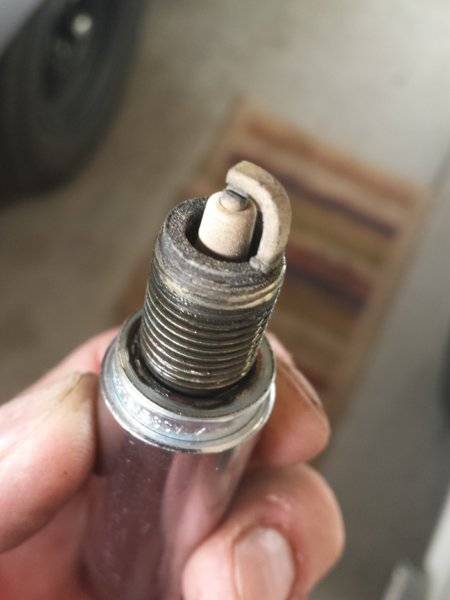

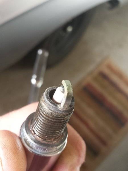

I just checked, all in is 34. 20 initial, and 14 mechanical. So I "should" be able to go as high as 24 initial with 38 being the all in total? And I have an o2 sensor sitting on my workbench, haven't installed it yet.
Is it too lean?
I don't think so. These are a few plugs I pulled to inspect. They are all about the same. I thought the same thing which is why I was messing with jetting but the result was burning eyes lol.
That carburetor comes from the factory jetted for sea level. What is Yuma, 165' elevation? You've got the secondaries 12% rich? Maybe you should rethink that.
I will take your recommendation and swap them down for the +4% or factory jets?

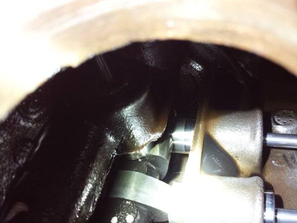

And here are a few pics of my cam lobes. You can see the lifter swipe over the entire top lobe of the cam. The cam is beveled and should only show wear on one side, correct? And yes, I do detect a sparkly, copper look to the oil on the cam.
